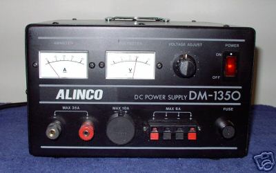

Filter caps look OK, but I'm going to replace them. The failure happened suddenly, where I'm seeing a voltage drop and a lot of "hum". I'm suspecting the bridge rectifier may have failed. I'd still like to get a schematic
Posts: 8334
« Reply #6 on: March 15, 2024, 01:56:34 PM »
Well, it makes a big difference if you supply the correct model number. You said, "PS-5500" when in reality it's an "EP-5500" Maybe you need to start your search over again. Power Supply was offered to the market around 1985.
You might also take a look at the Alinco DM-1350 power supply (it's only a 35 amp supply but design criteria might be very similar). Similar in style. It seems to me I remember Alinco going through some type of corporate change or restructure back in the 90's (or maybe I'm just dreaming) and they dropped a number of their older products. Older products also had the old Alinco logo. And it could be, that Alinco never generated any service related information (schematics) for customer distribution back then. You may have to generate your own actual drawing.
