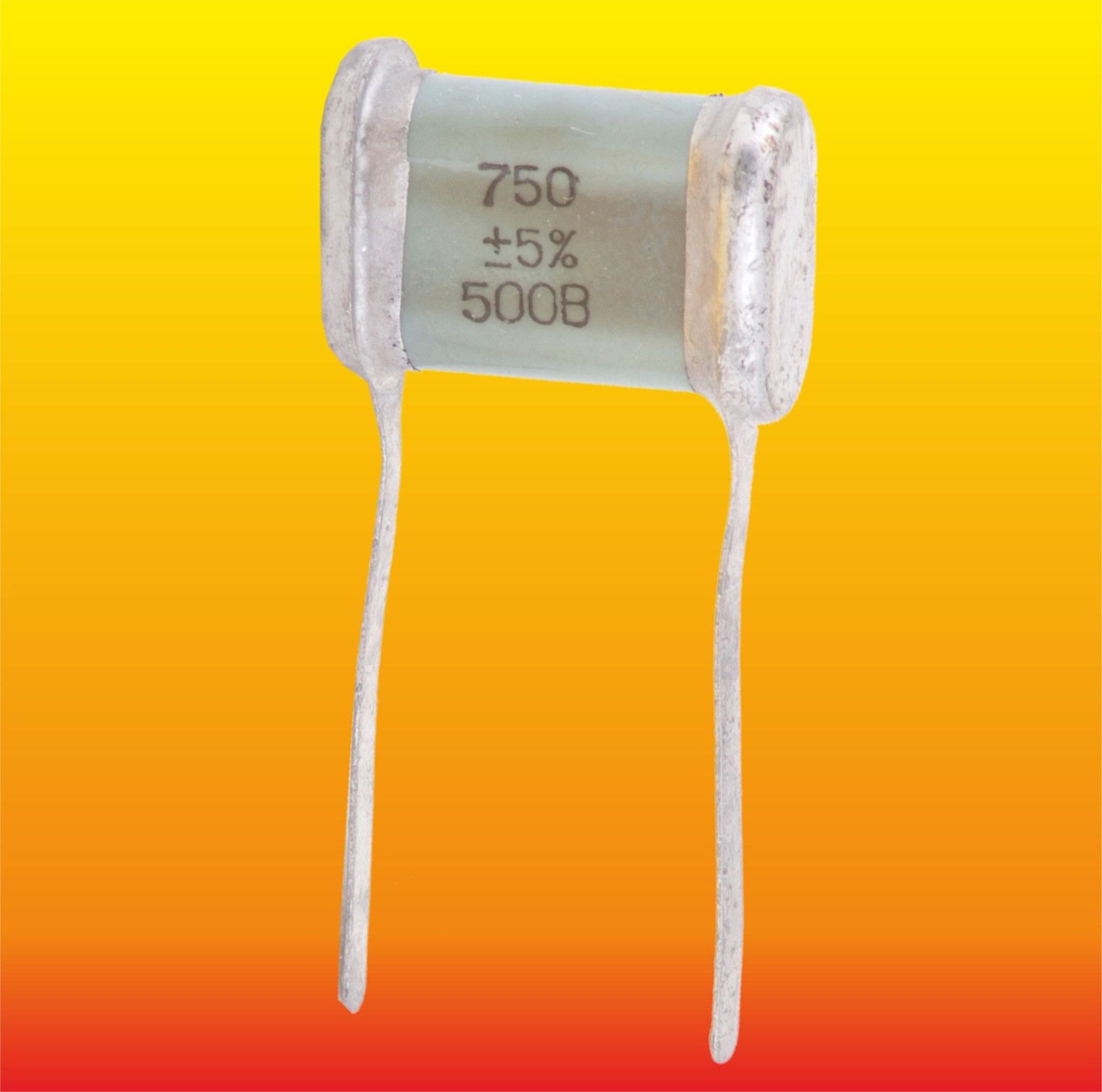

On the shunts, I would stay away from doorknobs.  I have had numerous failures of doorknobs - the good ones - and 100% failures with the not-so-good ones.
If you can't find ATC caps (I get them directly from ATC or on Ebay), you can use 2 of the Russian silver-mica 500V capacitors.  They work quite well.  Get 2 750s or whatever you can get.  A 1000 and a 500 will work in a pinch.  I've used them on a number of class E rigs and they work.
I just found a listing for these on Ebay 750pF 500V.  Perfect.  2 per module.  Try to buy a lot of them - you get a better price.
