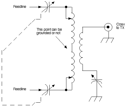

Hey, if somebody has a chance, could they draw a quick diagram of the link-coupled tuner? I dont know if its just a matter of not enough caffeine in the blood yet, but I'm having difficulty visualizing it!
Thanks,
Jason kf6pqt
W6IEE, formerly KF6PQT
« Reply #69 on: October 10, 2006, 11:26:23 AM »
I think the tom vu tuner is on this site somewhere ansl check out rick measures turer. frank is using a t tuner 2- 500 pf variable caps in series with a variable inductor to ground connected at the junction between the two caps.
The T tuner has a heck of an adjustment range but it is a hipass network so does not help much in reducing harmonics. The t might be easier to use with a low Z load.
A schematic is found in the article below.
http://www.amwindow.org/tech/htm/160smallants.htm

« Reply #71 on: October 10, 2006, 08:38:22 PM »
Awesome, thanks! Something tells me there was a direct link that I missed.  Tongue
