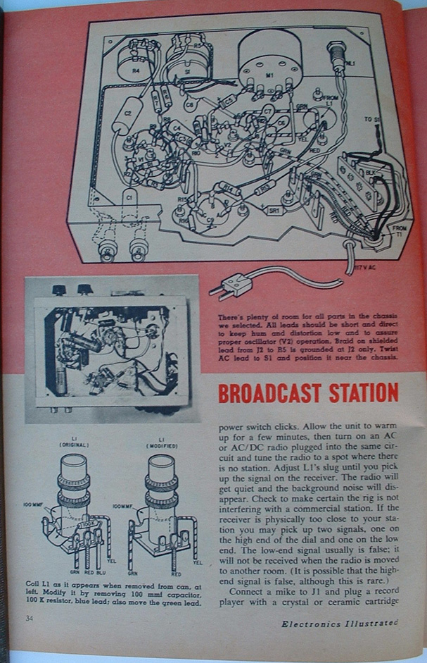

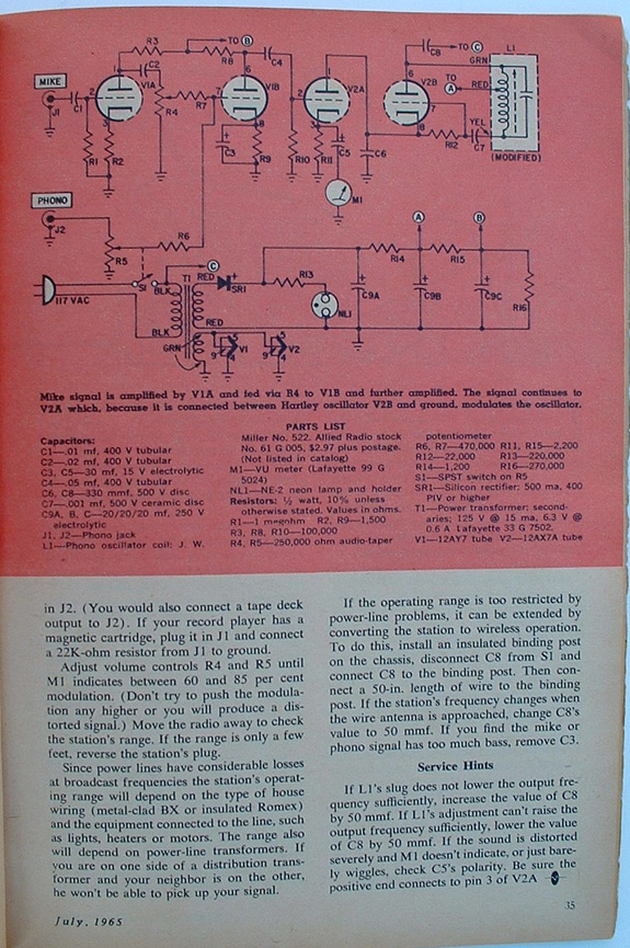

This particular Part 15 "AM Broadcaster" project fascinated me when as a kid, I read the original article in ELECTRONICS ILLUSTRATED. It's a 12AY7 driving a 12AX7, rf output coupled to AC house wiring. But I imagined modifying it for use with a real aerial and being the neighborhood DJ.
Sorry about the slow QSL.NET download. Anyone with a faster server who wishes to "adopt" these files is most welcome to.
(I skipped page 3 because it was just an advertisement)
http://www.qsl.net/wb1gfh/bcst1.jpeg
http://www.qsl.net/wb1gfh/bcst2.jpeg
http://www.qsl.net/wb1gfh/bcst4.jpeg
http://www.qsl.net/wb1gfh/bcst5.jpeg

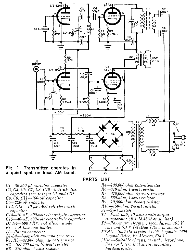

Interesting. Looks like a modulated oscillator though. Would be pretty unstable and wouldn't take much audio without FMing.
Here's a better design.
http://www.amwindow.org/misc/gif/xmitter3.gif

« Reply #4 on: June 11, 2005, 05:01:43 PM »
I also lusted for the little broadcaster when I was a kid with no money. About 10 years ago, I built it up. What a major disappointment. Drift, hum, and a range of about 20 feet. Forget about turning your house wiring into a giant antenna. It just didn't shake down that way. I could get about 20% modulation before the FMing made the distortion unbearable. I can email you photos if you're interested.

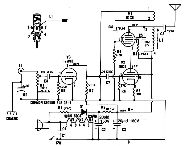

Here's another one I found stuck in the gigabytes of crap on my computer. Modulated oscillator and no power transformer.

Quote from: Steve - WB3HUZ
My homebrew ones always used series string filaments, from the old "All-American Fivers."  Never tried a power transformer version.  One that I recall used 50L6 rf output, 35Z5 halfwave rectifier, 12SQ7 (triode section) rf oscillator, another 12SQ7 mic preamp, and some other 12-volt tube (don't remember which one) as control grid modulator.  One side of 110v line was connected directly to the chassis, and the thing had no cabinet.  I even used it outdoors a few times!
