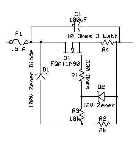

Steve, your drawing would appear to work fine so long as the "input to output" differential doesn't exceed 112 VDC.  Once there, it would appear the circuit then simply becomes a pair of Zeners in series.    Or am I missing something?
Mike
Mike
Hi Mike - Yes, It's designed so that once the voltage drop across the circuit reaches about 106 V or thereabouts, the drop stabilizes (hence the term amplifier zener).
With the bypass capacitor across the circuit as shown in the diagram, it makes a nice constant voltage drop device.

Well it didn't take long for your drawing to end up in my Google image search results for "amplified zener". Shocked
https://www.google.com/imgres?imgurl=http%3A%2F%2Fwww.classeradio.com%2Famplified_zener.jpg&imgrefurl=http%3A%2F%2Famfone.net%2FAmforum%2Findex.php%3Ftopic%3D44400.25&docid=addRlHsB5WanJM&tbnid=SCAKaNggmZ0C9M%3A&vet=10ahUKEwjVjtjhtYffAhURnKwKHUWCBRYQMwhCKAUwBQ..i&w=699&h=393&client=firefox-b-1&bih=601&biw=1360&q=%22zener%20amplifier%22&ved=0ahUKEwjVjtjhtYffAhURnKwKHUWCBRYQMwhCKAUwBQ&iact=mrc&uact=8
I received a pack of ten STP7N95K3 MOSFETs today. When the zeners arrive, I'll be busting out the clip leads!
I plan to build an amplified zener, regulator, and sweep tube screen grid driver circuit with them. All to be fitted to my DX-100. It should be interesting.

« Reply #34 on: December 05, 2018, 12:54:08 AM »
...Hi Mike - Yes, It's designed so that once the voltage drop across the circuit reaches about 106 V or thereabouts, the drop stabilizes (hence the term amplifier zener).
With the bypass capacitor across the circuit as shown in the diagram, it makes a nice constant voltage drop device....
Understood, but my comment was in reference to the situation where the current set by "R-prot" is exceeded by some significant amount.
At which point, all excess current, which is undefined but could be substantial, is supplied exclusively through the two Zeners, which probably wouldn't last long.
Certainly not a "flaw", but I'd opt for some protection so I only need to replace as few parts as possible.   I do enough of that all ready. Smiley

« Reply #35 on: December 06, 2018, 12:06:44 PM »
Yes, that could definitely be improved.  And should be in a practical implementation.  Thanks !!

If "R-prot" were moved to the output of the circuit (just to the right in the drawing), wouldn't the 'FET continue to maintain the ~100V drop and cause no additional current through the zeners?
All your worries won't add a day to your life, or make the ones you have any happier.
« Reply #37 on: December 07, 2018, 01:00:48 PM »
Here's an improved circuit, with protection for the zener.  And real values for the components :-)

« Reply #38 on: December 07, 2018, 05:12:29 PM »
Looks good. Smiley
My build will be using an STP7N95K3. It has back-to-back 30V zener protection built-in (gate to source), but I'll keep D2 (12V) anyway. With 800V on the input, I'll be using a microwave oven HV fuse (5KV rating) at F1. I had already exploded a "3AG" 250V fuse with HVDC some years ago — it wasn't pretty. I'm assuming that the value of C1 isn't too critical and a voltage rating of 200V would be sufficient.
This should be a fun experiment for lowering the B+ on the DX-100 RFPA. I'm still in the process of putting SG driven sweep tube modulators in it with 'FET source followers driving them. Maybe a 'FET voltage regulator will find its way in there too. There's nothing wrong with hybridizing the old girl! Grin

« Reply #39 on: December 08, 2018, 05:22:35 PM »
Sounds good!  The value of C1 should be such that the capacititive reactance should be low at, say, 30Hz, as compared to the resistance of the load (in this case the RF amplifier and anything else out there such as a screen dropping resistor that comes from the modulated DC.

« Reply #40 on: December 08, 2018, 06:59:25 PM »
Thanks, Steve.
Let's see if I understand your circuit...
The zener amplifier is acting like a variable resistor, dropping a fixed amount of voltage (100V) regardless of the current drawn through it.
In my proposed application, assuming an RFPA average current of 250mA, it will appear to be a 400 ohm resistor, not only at DC, but also to the audio, which then requires it to be bypassed with a capacitor of low reactance (at the lowest desired modulating frequency) so as not to absorb that audio.
In effect, it's a 400 ohm resistor at DC, but a lower value resistor at audio frequencies (53 ohms at 30Hz). Thus, with 700V at 250mA on the RFPA, the modulating impedance of 2800 ohms is much greater than the 53 ohms, and very little audio power will be lost in the zener amplifier.
Now, if I've got all that right (and assuming the average current of 250mA is drawn by the RFPA), would an equivalent circuit simply be a 400 ohm 25W resistor bypassed with a 100uF capacitor?
As cool as the zener amplifier is, I want to make sure I'm not over-engineering a solution.
