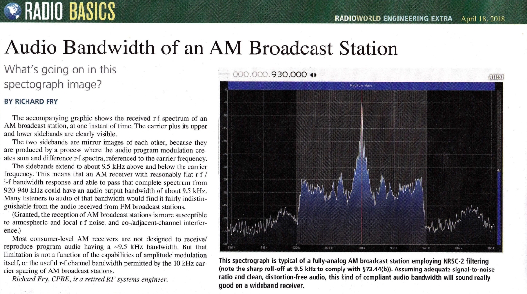

Comments to consider/add to the discussion mix —
The graphic below shows the output of an SDR looking at the r-f spectrum of a local, 5kW, non-directional AM broadcast station located about three miles away from the receive setup.
Splatter is produced as a function of the very short gaps in the carrier output during excessive negative-going modulation, analogous to the key clicks that can be produced when using very short on-off transition times when keying a "CW" (Morse) transmitter.

Just about any modern AM transmitter out there will transmit audio out to at least 10kHz. I just ran a Proof-of-Performance on a local 10kW PDM modulated transmitter back in the spring and the transmitter, without processing, could re-produce audio (with at least 100% Modulation) out to 15 kHz before it started rolling off.
There are two limiting factors in play for decent AM audio:
1) The example Mr. Fry gave shows how the AM receiver, and not the transmitter, is the factor limiting AM bandwidth and audio quality because of its narrow bandwidth IF strip,

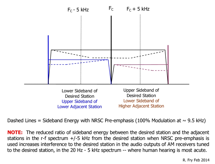

... The example Mr. Fry gave shows how the AM receiver, and not the transmitter, is the factor limiting AM bandwidth and audio quality because of its narrow bandwidth IF strip...
Sorry, but that is incorrect.
The SDR device used to produce that graphic was/is essentially flat across that entire r-f bandwidth.  The steep rolloffs shown for the upper and lower sidebands at about Fc ±9.5 kHz are the result of the audio processing needed for the transmitter to implement the NRSC-2 curve in its transmissions (see below).
The NRSC-2 analog AM audio spec includes pre-emphasis for program audio below about 9.5 kHz, and calls for appropriate de-emphasis in receivers.  However most consumer-level AM broadcast receivers do not pass much of the transmitted spectrum beyond Fc ±4.5 kHz, or so.
I am not sure to what you are objecting.
The "example" I was referring to is the whole article 'paste' including the spectrum sweep plus the text:
"...Most commercial-level AM receivers are not designed to receive/reproduce program audio having a ~9.5kHz bandwidth. But that limitation is not a function of the capabilities of amplitude modulation itself...."  Emphasis mine.
This implies, and rightly so, that it is NOT the transmitter proper that limits good audio, but the fault lies with the receiver's IF bandwidth that can make AM audio sound "muddy." Add to that the crummy processing "re-set" by non-engineering Program Managers and you have muddy audio.
Without a wide bandwidth for reception, any audio beyond ~ 4.5kHz is essentially lost.
The NRSC Pre-emphasis helped somewhat but did not solve the problem of receiver bandwidth; i.e., it was a bandaid at best.
The latest version of NRSC permits fixed audio pre-emphasis with an upper frequency limit of about 9.5 kHz. The pre-emphasis was intended to compensate for the sideband rolloff of the r-f filters (mostly the IF filters) in the receiver.

...  So a receiver manf. could design and market an AM broadcast receiver with an audio output that was fairly flat to about 9.5 kHz. ...
That wouldn't be too useful at night due to the skywave signals of analog AM broadcast stations only 10 kHz offset from a desired station (see the graphic below).
The interference issue when using receiver rf/if bandwidths of ~ 19 kHz would be especially bad for North American "Class A" AM stations assigned on a set of 10-kHz-adjacent carriers, such as now done for 740/750/760/770/780 kHz.
I am quite familiar with the "bandwidth" situation, and I see no offering of solutions to improved audio delivery for AM, which is one of my primary concerns if we are to make AM viable again.
