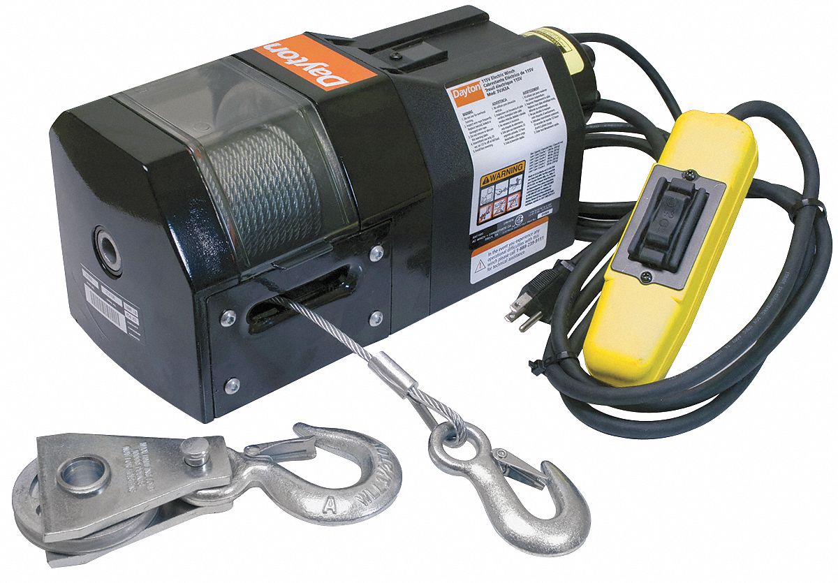

Pete nice set up looks good. Like you I know not to climb a crank up tower..... what electric winch did you use for tilt over functionality  and do you have a photo of the set up? I need to do that fabrication as part of the base configuration

On my tower, there is a roughly a 10 foot stationary post assembly that is anchored to the cement base along with 2 struts bolted to the post assembly and anchored to the cement. The cement base is roughly 7 yards of concrete and re-bar, and below the concrete is roughly a ton or two of blue-stone rock. The post assembly has a hinge plate on top and the tower tilts at that position. I believe yours pivots over at the ground level.
The new tilt-over winch is a Dayton 3VJ63. The crank-up winch is the U.S. Tower MD-75 with the 1 HP motor.
This isn't a great photo but it shows the tower fully nested. I'll try to take some photos over the next several days.
Tilt-over Winch:
