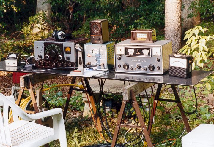

I've always liked the looks of this pair.
They physically match in size, and they just seem to look right together.
The HQ-100AC is a good receiver. NOT high performance. You can get images on it, but the selectivity is adequate, it's got average audio quality, it's easy to work on, and they're not very expensive.
Larry, W8ER has come up with some mods to improve the fidelity and AGC, but you will need to decide what you want out of your AM station.
It is not my primary receiver.
(this was a backup HF station I cobbled together for one of the AM Expeditions to Thomas Point Lighthouse, K3L. As it turns out, only the "table" made it out there. That's a back door from a rack)
