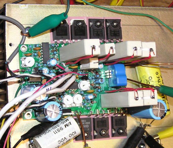

Well, I got the new Easy class H modulator boards back from ExpressPCB.  It took me about 1.5 hours to stuff the board (including gathering all the parts), and everything came up the first time.
The on-board implementation (4 modulator MOSFETs) will support RF amplifiers up to 5 Amperes at 30 volts carrier out.  The board could be used with higher voltages (up to 45 volts DC at carrier at 4 amperes).
Here is the board mounted on a 12 x 6 heat sink, and there is more than enough room to built the entire RF amplifier on the same heat sink (which is what I'm going to do), creating a compact, 150 watt (input - about 135 watts out) transmiter.
I do have extra boards if anyone is interested.

« Reply #5 on: February 09, 2010, 10:26:55 PM »
Do you have a schematic error at the current sense? It sounded good tonight. fc
« Reply #6 on: February 09, 2010, 10:48:20 PM »
Hi Frank,
I don't believe there's an error, but please let me know what you see, so if there is something unusual, I can correct it !!
« Reply #7 on: February 10, 2010, 12:17:51 AM »
I see what you see Frank....
But it's not an error....
I believe Frank ist talking about how the hall-effect sensor APPEARS to be in-between the two IRFP260n's.
But, in fact the fets are still in parallel., And the current from just one of the IRFP260n  is being monitored.
At least, I believe that's the idea.   Grin

Hi Frank,
The overload detection methodology gets real interesting  Cheesy  In this case, the output of one MOSFET is measured to allow the builder to configure from one to many MOSFETs without having to change any values in the overload circuit itself.
In the unlikely event of a modulator MOSFET short circuit, the board-based monitor circuit would not sense this as an overload, as the output current and voltage would track (which is what this circuit measures).  A secondary circuit located in the power supply is used to shutdown the modulator in the event of such a problem.  But, it would be possible to monitor both MOSFETs on the board and such a change would be quite simple.
It is very interesting comparing the PWM to the class H modulator.  The biggest difference I see is the lack of filtering in the class H modulator.  All of the PWM systems have a multi-pole aliasing filter, and of course the output filter.  All these add phase shift, and of course they compromise the high frequency response which is what the filters are supposed to do.  There are also no ripples in the frequency response of the class H modulator.
These differences are audible in headphones, although they are quite subtle.
On the design - that source follower after the voltage amplifier really solved a lot of problems!  Due to the variable nature of the load represented by the gates of the output MOSFETs (the capacitance varies, and the reverse transfer capacitance couples the output to the input), as the frequency is increased, the effects of the capacitance on a pullup resistor only voltage amplifier became quite pronounced !  And, the effect become increasingly worse as the voltage rose, and the current through the pull up resistor become lower and lower.  I observed this myself during the design phase.  So, I added the source follower and got rid of all those problems.
Further enhancements in this design come by running the voltage amplifier and source follower MOSFETs to the -12V supply.  This gives an effective increase in the voltage swing available to the gates of the modulator MOSFETs of 12 more volts.  This additional positive swing is recovered across ZD5 (bypassed by a 10uF capacitor), and effectively allows the gates to be driven sufficiently positive with respect to the source to allow the output MOSFETs to achieve saturation at the full supply voltage.   So, the maximum positive peaks are realized and none of the supply voltage is wasted due to the threshold voltage of the MOSFETs.
The negative peak limiter is an improvement over previous designs in that the limiter supplies very little current - leaving the output MOSFETs to carry the load.  The limiter is also adjustable.  Previous designs used a low voltage power supply and a diode to directly supply the RF amplifier.
Anyway - a few design ramblings  Cheesy   I had fun doing the design !
