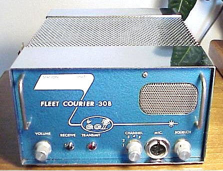

I can't remember all of the details, but 11 meters was one of our ham bands. It then became a commercial band, I think, for a very shot time until the FCC finally made it the public citizens band. Those blue face commercial Courier's came from an old deliver truck and base setup before the CB band was established. They were really old. Much older than the Courier CB stuff from the 1960's. I did some search’s, but I cant find or remember the model numbers.
I pulled this down off some web site some time ago:
The 11 meter band was never a primary amateur band. 1947 -The Atlantic City Conference - Amateurs lose parts of 10 meters and 20 meters, but will gain a new band at 15 meters in 1952. To compensate for the loss, the FCC allows use of the 11 meter band (26.96 to 27.23 Mc) on a shared basis with Industrial, Scientific and Medical devices.
Early 1957
FCC Docket #11994 proposes reallocating Class D in the very underused 11 meters Ham band 26.96-27.23 MHz (USA-only). At this time there was little business/military use of 27MHz and model control on 27.255 was inadequate, being shared with paging and other services.
11th Sept 1958
The 11 meters ham band is reassigned to models and Class D Citizens' Band radio.
Maybe the Courier you're thinking of is the Fleet Courier.

Here's a pretty one:
Todd, KA1KAQ
Posts: 4259
AMbassador
« Reply #23 on: August 19, 2008, 11:32:46 AM »
They sure knew how to make sets attractive back then. Blue hammertone, polished aluminum knobs, chromed cabinet... nice stuff. I've got one like this, also one of the older black-faced Fleet Couriers along with a 'new' pair that came out of the West Topsham fire engines back in the early 80s. IIRC, the last model uses a big Compactron output tube that provides considerably higher power out. They were considered business band sets and not regulated the same as 11m stuff.
The Model 23 was made in two versions (dressed up differently over the years), one of which had the 'Range Boost' switch under the meter for increasing the modulation. They're pretty straightforward rigs to work on and should produce 8-10 watts out when adjusted properly. A number of companies including Radio Shack sold re-badged versions, so there are plenty of them around.
The old Johnson Messenger I is another favorite with the 10m folks. Power not being an issue when the band is open, frequency agility is the only limiting factor. But isn't that part of the fun?
