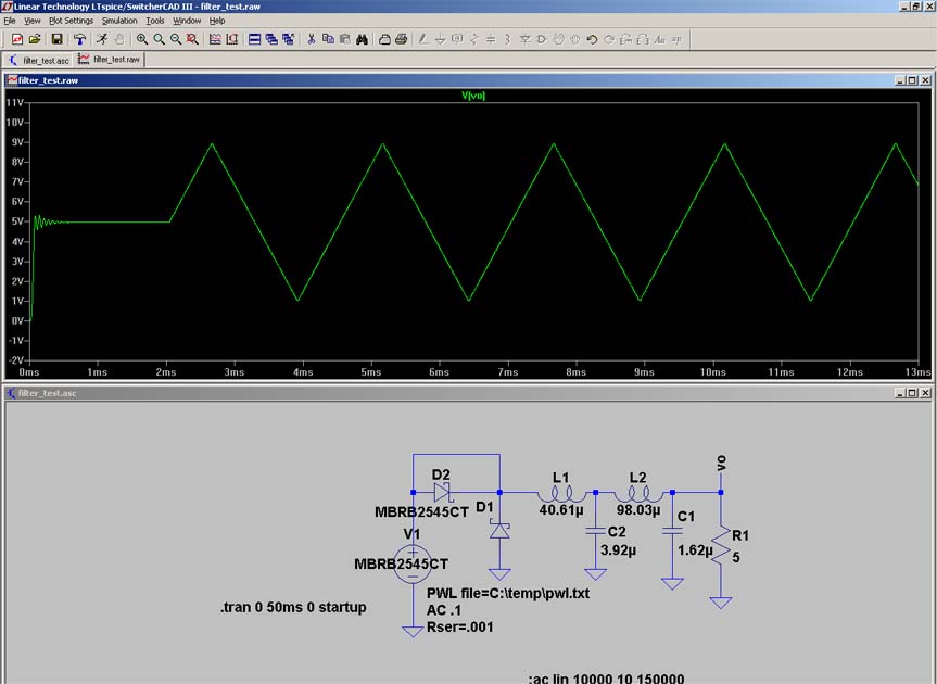

Many people here have been using SwitcherCad for simulations of filters, etc.  One of the problems with the simulations is that the waveforms are static (not modulated), so characterizing the filters is difficult at best, so I wrote a program to generate a .PWL file, used by SwitcherCad as input.  The .PWL file contains a (long) series of modulated pulses.
So, for all you filter-simulation junkies !!
I have released my program to generate .PWL files.  This program will generate pulse width modulated waveforms, suitable for use in switchercad. NO GUARANTEES !!! But, it does appear to work correctly.  When you specify your independent voltage source in switchercad, specify a .PWL file as its input rather than a specific pulse width, etc.
The program features sine, square and triangular modulation waveforms. You can specify the modulation level, frequency, duty cycle (carrier level), switching frequency, anti-aliasing filtering level (the filter is poor, and will modify high audio frequency waveforms, but it does work), negative peak limiting level and a few other parameters.
This is a command line program which will run under all version of windows.
Copy the program to your hard drive, run it (usually done from a command line).  The output file defauilt name is pwl.txt, although you can specify your own file name.  Other command line arguments are also documented (type, at the command line, makepwl <return> and it will show you the arguments.  For those who are absolutely married to the Windows interface, use the start->run->makepwl.exe  (put makepwl where you can find it later!).
The program is here: http://www.classeradio.com/makepwl.exe
Please report any bugs, etc.  No guarantees on when I might get around to fixing them, but I've used the program a lot and it works very well.  Tongue
Here is a SwitcherCad simulation output (with the schematic).  I used the makepwl software (see above) to create the PWM signals used in this simulation.
The switchercad file is here: http://www.classeradio.com/filter_test.asc
The output looks like this:

Steve, Why do you have D2 shorted? This does not match the configuration of the PWM and will modify results? I added the diodes in the files I sent you because I wanted to match the performance of the switch. I'll play with this tonight and report back. Net narks won't let me open you file here. fc

You can dump a Wave file into SwitcherCAD. It's very easy to make one as dynamic is you'd like.

Huz,
I wonder if you can point me to reading material on making pwl files. Steve QIX didn't know of any place to look and searching the web juse gets me password hack informatiion. Looking at Steve's filter there is ripple just past the peaks that can be tuned flat.

No need to mess with a PWL file.
Create your wave file with whatever software makes sense - audio editor or sig gen app. Save the Wave file (e.g. filename.wav) in the same directory as your SwCAD/LTSpice data files.
On your LTSpice schematic make your source an independent voltage source, V1. Make the value for V1
wavefile=.\filename.wav chan=0
That's it. Done.
Below is a simulation of the filter following the clipper stage in an Eico 730 modulator. As you can see, with 6 dB of clipping on real audio (me saying the famous AM test phrase yeeeaaaaaaa) as the input, the overshoot induced by the filter tends to make larger peaks than before the clipping. This is why using a clipper/filter on an AM rig generally sucks. It does nothing to reduce the peaks and just creates distortion. The impulse response of the simple lowpass filter is very poor.

Yes an underdamped filter will cause overshoot and false positive peak distortion. An old German (SK) boss I had in the '70s set me straight and SWCad reminds me of his talent.
The best transient is a square wave for finding the effect of a step response but Steve's triangle wave shows it also if you look closely just past positive and negative peak.  The nice thing about a square wave is that is is a stable level after the transient. That is how a TDR works. Old Gunther Ritz did the TDR in his head right off the 545B screen. TNX for the ideas I'll pass it along to the guys at work. I did CS116, CS115 and now we have lightning. These are cool tools to keep everyone honest. Now to convince the power supply guys their filter tool doesn't work.
