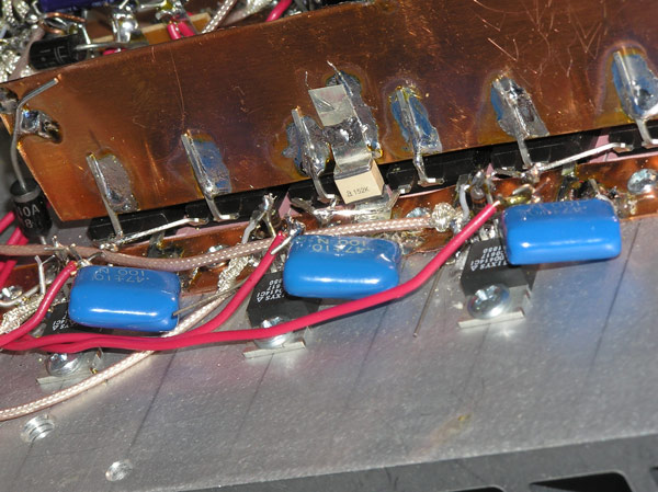

Here's some shots of the rig cobbled together ready for a test. The cables to each module are intentionally long so I can pull each module completely out of the cabinet to work on. It still needs covers and dressing up. I will test and perfect everything first before tie wrapping and making the wires look good. I expect to be pulling modules in and out for a long time yet during testing and troubleshooting.
Notice the side cabinet access for the RF deck. This will have a door later on.  Also notice the two layers on top - the control circuitry on top and the PDM modulator below.  The RF deck sits in the bottom of the cabinet. There is room to add another 24 RF pills next to the first RF deck.  The bottom of the rack holds only the RF deck and tank circuit, so there is room to play in there.

Hmmmmmmm.. I just noticed a couple of things that you may want to consider fixing before attempting normal operations.
There appears to be a "driver bus" rather than individual coax cables running to each IXDD414.  This did not work in my own transmitter.  It works OK with 4 MOSFETs and 2 IXDD414s per side, but when I went to 6 MOSFETs per module with 3 IXDD414s, there were parasitics caused by the long, unshielded driver input bus.
I corrected the problem by running an individual coax cable to each driver, with termination (300 ohms in this case - 6 devices per phase).  I would recommend fixing this.  Also, do ground the shields at the driver coax cable common point - where they all come together.  It should resemble this:
Second - hey, what's all that extra wire connecting the output transformers???   Roll Eyes  This will surely introduce inductance that's not supposed to be there.  The primary and secondary wires should all be exactly the same length for each transformer, and be as short as possible.  Similar to this:
The transformers started out like this:
The shunt capacitors are way over at one end of the drain bus.  They should be in the middle, or use 2 capacitors of 1/2 the total value and put one at each end.  For 160 meters, you can add additional shunt capacitance at the end, as long as this is not the total capacitance of the shunt capacitor.
The entire transmitter, with all the construction steps is shown here:
