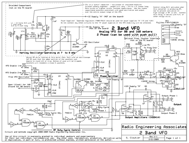

« Reply #86 on: April 11, 2010, 09:24:00 PM »
VFO and splitter/ digital driver schematic-
http://www.classeradio.com/vfo_2_band.pdf
« Reply #87 on: April 11, 2010, 09:32:55 PM »
That is truly nasty... !
Tom... please send me the schematic Steve sent you to build the board!
Thanks...

« Reply #89 on: April 11, 2010, 09:57:31 PM »
I wondered WHY you posted this schematic link......
Because this link does NOT go with the board!
The one you scanned does...
« Reply #90 on: April 11, 2010, 10:04:00 PM »
Bruce,
Here's the "Two-Band VFO" schematic I scanned for you.
I tried an HP external sine generator and the digital board output looked the same. So it's not the VFO / buffer.  Does the sinewave have to be squared off to drive the board properly or can a pure sine do it?  I notice Steve talks about adjusting to get a sine saturation waveform.
Pure sine wave up to the base of Q2.
At the emmiter of Q2, it is clipped...
Not at all what your scope pattern shows....
Your last two pictures should look very much like the two pics at the bottom of this page...
http://classeradio.com/vfo.htm
« Reply #91 on: April 11, 2010, 10:30:02 PM »
But no... the sine does not have to be squared off....
You basically just need about a 3 volt positive pulse to clock the flip-flop.
Anything negative will be wasted to ground via a resistor.
Sumpin not right in the set-up Tom...
« Reply #92 on: April 12, 2010, 07:20:14 AM »
Hi - here is the correct schematic, and a link to the same  Cool
The oscillator section should produce about 3 volts (or a bit more) - sufficient for a logic 1, and enough to drive the first flip-flop.
Link: http://www.classeradio.com/vfo_2_band_rev_c.pdf  The old schematic on the class E web site had also been replaced, since we have the new one.  The old one is completely valid, but the new schematic goes with the boards that I made.  Note: the next board rev will contain *minor* revisions, so a new schematic will be available for that one.
Picture:
« Reply #93 on: April 12, 2010, 08:19:04 AM »
1) VFO out
2) VFO Buffer out as in goes into the digital board.
3) Overshoot/ringing of the final digital output at 12v p-p.  What could cause this?  The carrier sounds clean in the receiver and is stable.
I just tried the digital board with an external sine wave signal generator. The digital board output still has overshoot.  Maybe the sinewave drive needs to be more square/pulse-looking to generate a clean, square output.
The input will not affect the output waveform unless the input is causing the flip-flop to unlatch due to ringing.  It is hard to know if the waveform REALLY looks like that, or if this is a measurement anomaly.  I say this because all fast edges shown in your pictures appear to have ringing.  Can you look at any fast edges cleanly?  check the output of the 74AC112.  What does it look like?
Is that measurement right at the board itself?
I have found that the SLIGHTEST inductance in the measurement system (the probes, grounding, etc) will cause ringing where none is actually present.  I have build a number of these VFOs, and the output is a clean square wave.  This is what I get:
Ignore the high duty cycle.  It should be more like 30 or 35%.  The important place to measure the duty cycle is at the gates of the RF amplifier MOSFETs.  It should be about 40% to 45% THERE, which means it will be smaller at the VFO because every IXDD414 adds a bit of storage time!!
I use a Tektronix 475A with 100mHz Tektronix probes.
As an aside, I have some 20 foot runs of coax (and some much shorter) running from the VFO to various transmitters.   Even the output at the far end is quite good, so it should be excellent at the input side.  I put a selector switch on my VFO, allowing me to select between up to 5 different RF amplifiers.  I got tired of disconnecting cables when changing transmitters  Wink   That's a nice feature to have!
Sorry you had trouble getting the oscillator section of your VFO to produce enough output (reference from a previous reply to this thread).  Your experience is not typical  Huh  Did you finally use 2n3904 transistors (as specified in the design) or continue with the 2n2222?  Both should work, but the 2n2222 has a higher input C, and appears to be a little slower, so some values might need adjustment.
Regards,
