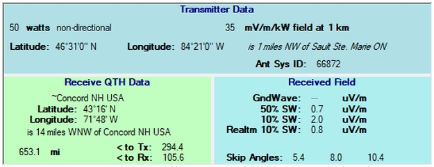

I am interested to copy a 428kHz / 25W  airport beacon (POH) in Iowa.  I am in Warner, NH....
Using FCC methods, below are the nighttime skywave fields expected for a similar path length from a 50W ERP transmit system on 530 kHz.
Probably even those fields would be well below the ambient r-f noise level at the receive site, unfortunately.
