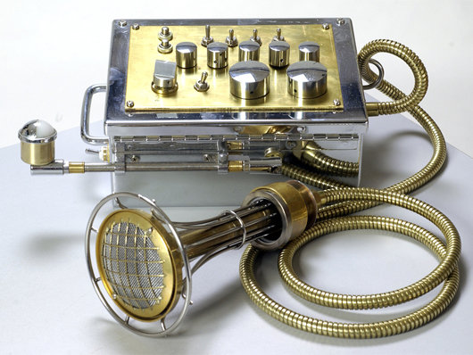

« Reply #7 on: February 02, 2011, 12:26:48 PM »
I want one with a brass front panel.
W1UJR
« Reply #8 on: February 02, 2011, 12:27:49 PM »
I want one witha brass front panel.
Steampunker!
Bruce's New Retro 75 Case :-)
