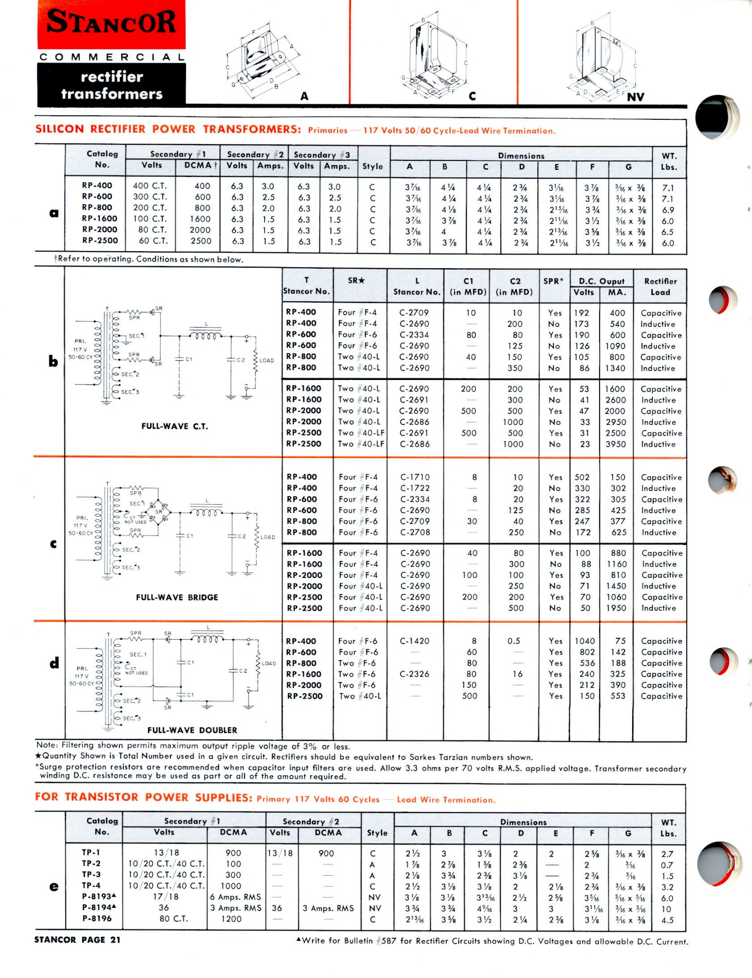

Greetings everyone,
 Does anyone have any info on this unit? I contacted Stancor and their response is the unit is too old for them to have any info on it. Go figure!
Thanks,
 Ray
rsumperl@hhk.com
WD5JKO
Posts: 2003
WD5JKO
« Reply #1 on: May 13, 2010, 10:15:26 PM »
Thanks to fellow AM'er, Patrick (Opcom)
Scroll down to the bottom at 21E...
http://www.bunkerofdoom.com/xfm/stancor1966/stan66_021.jpg
