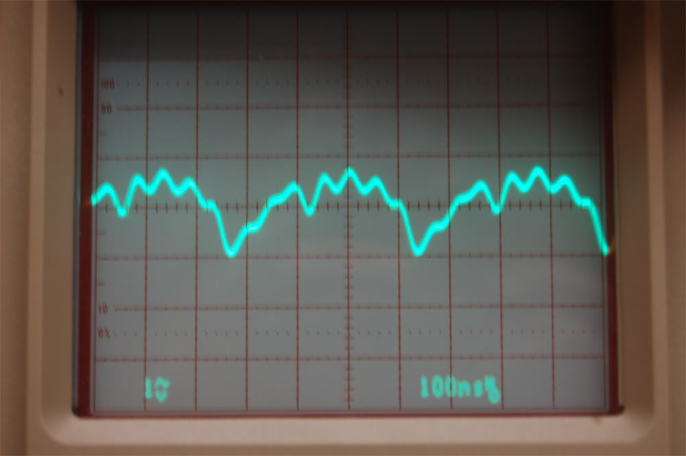

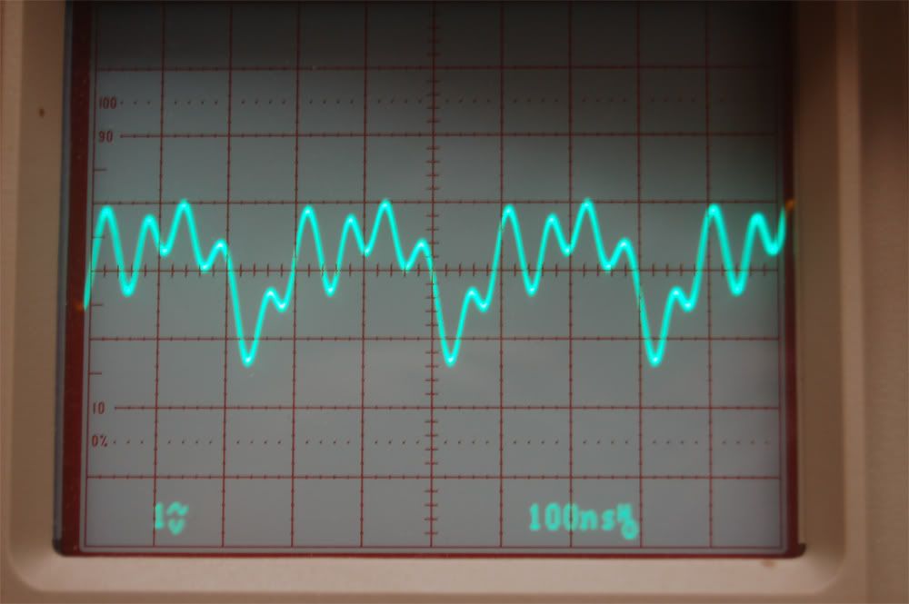

« Reply #6 on: August 02, 2009, 10:24:27 AM »
FYI - This is what I am getting off the plate with a 47 pf blocking cap to the scope probe. The Bandset cap is move from full mesh to open for the two photos.
The tube is metal and pin 1 is grounded. The BFO uses a 6C5 and works fine. It was suggested that I add a series 27 ohm resistor in the grid. The grid lead is longer than I like . I layed the radio out per the handbook though.
Pat
N4LTA
KM1H
Posts: 3514
« Reply #7 on: August 02, 2009, 11:07:24 AM »
That looks like a classic case of parasitics Pat. Plus a bit of 2nd harmonic.
The 27 Ohm resistor is something to try. If that doesnt work Id wind a mixer coil without the regen winding and remove the pot, etc from the circuit. Get the radio to work as a normal receiver first before getting fancy.

« Reply #8 on: August 02, 2009, 11:19:03 AM »
I havent got to the mixer yet. It is the last thing to build. I wanted to getthe LO working first. A 6C5 is a bit better. The 27 ohm made no difference. Lowering my finger into the lo coil and holding it very lightly eliminates the parasitic, so it seems that the whole assembly has a  self resonance at the parasitic frequency.
The parasitic is in the LO - not the mixer stage. I need to clean up the LO before I start with the mixer.

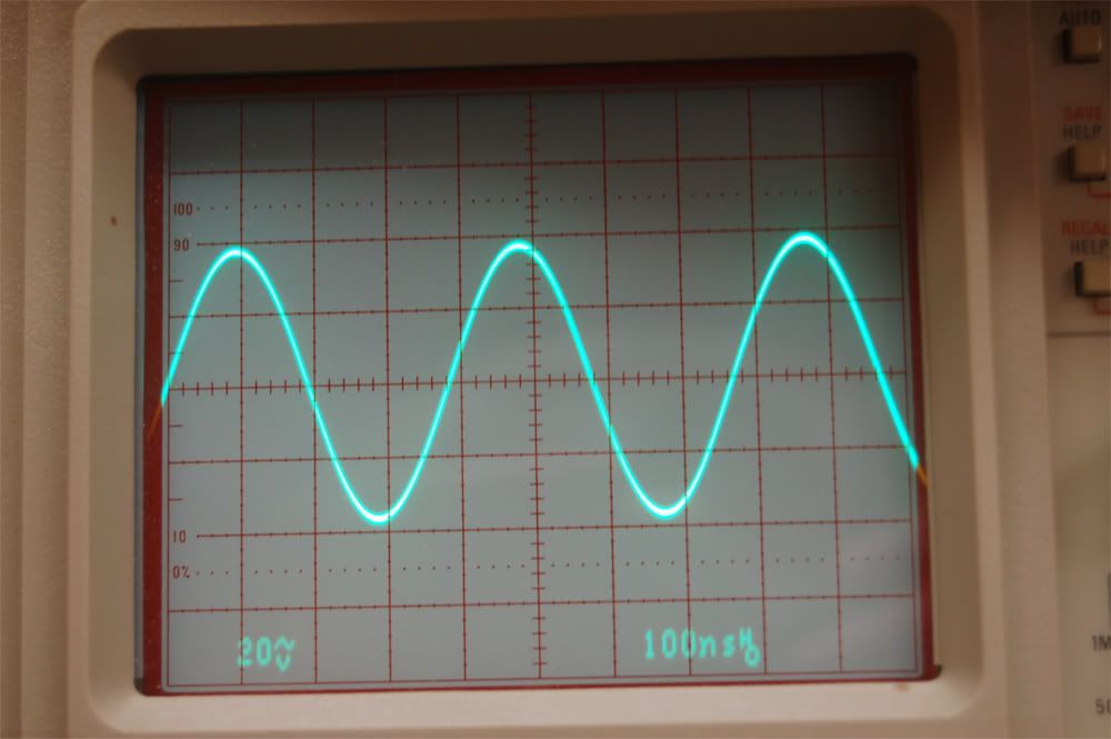

N4LTA
Posts: 1070
« Reply #10 on: August 02, 2009, 06:30:05 PM »
Pulled it all out and used a tapped  coil hartley circuit - same caps - rewound a new coil.
First time results below.
I hate it when these mysteries happen. I tried just about everything including removing the Bandspread tap to clean it up?
Thanks everyone for the tips and assistance.
Pat
