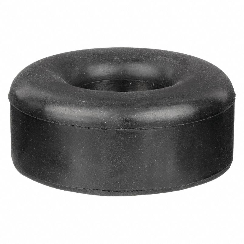

I went through this several years ago with my first T-Bolt. The original feet are no longer in production.
I opted for these shown below from Grainer, 5 for $10. They also sell a similar one, same diameter but not quite as high.
https://www.grainger.com/product/16ZD79?ef_id=CjwKCAjwoP6LBhBlEiwAvCcthJG1V5v-PDzjfXYL3QZg-5R57FTEN8A3y3u-G8HFfJhTK1hMZt7QsxoCC7IQAvD_BwE:G:s&s_kwcid=AL!

Those look nice Pete! I guess I should have come here first rather than looking at everything in HD?
