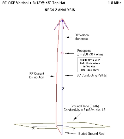

An ~accurate response will need the depression angle for those sloping top sections, the horizontal dimensions of the roof, the X-Y location of the vertical on the rooftop, and the operating band(s).
If you will post those, I will use NEC4.2 to model the whole system including an estimate of the 60' paths to r-f ground (Earth potential), and post the results.

« Reply #5 on: March 14, 2020, 05:28:14 AM »
... Since there are six 6' radials at a 90 degree angle, three 12' radials of a similar diameter should present the same capacitive value. However, their slope downward will simultaneously reduce their exposed area to the counterpoise while also reducing the distance.
Below is a NEC calculation of the feedpoint Z of a system resembling your description when using 3 top hat wires each 12 feet in length with a depression angle of 45 degrees.
I don't have enough detail to model any other conductors at/near the rooftop, but the feedpoint Z of this configuration is rather close to what it is when using a top hat of 6 horizontal wires each 6 feet in length.
