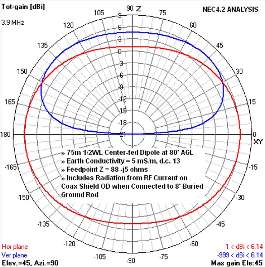

... 2.) Use your coax dipole as you have it now, but put a coax balun coil at ground level, and earth the shield of the coax side going to the shack (gnd rod). This will embrace coax radiation instead of minimize it. ...
Below is a NEC4.2 study showing how that configuration might perform:

Why avoid a vertical component?
I'd put the chokes where the coax turns horizontal and can be easily supported from the ground.
« Reply #20 on: November 14, 2019, 09:41:42 AM »
Hi Clark, it's not so much that it's vertical per-se, but that there are increased ground losses (due to imperfect ground), and also the significant low angle component does not help the signal locally (within 500 miles), which is where most of the action is most of the time.
There is already some vertical component because the antenna is not purely horizontal.  This is also the situation in Townsend with the antenna being somewhat inverted V shaped, however there I have a real radial ground system with 100+ 1/2 wave radials (1/2 wave on 75 meters that is).
