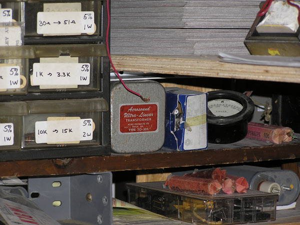

« Reply #8 on: January 31, 2010, 01:47:12 AM »
Or would it be better to use this transformer as a door stop.
Naaaaaaahh.  I wouldn't use it as a door stop.  Someone might get a broken toe.  I find they work out very nicely for holding up shelves in my make-shift work bench  Grin
« Reply #9 on: January 31, 2010, 01:49:00 AM »
Oh, and by the way, that particular transformer is bad (shorted).  Just so you know  Wink
