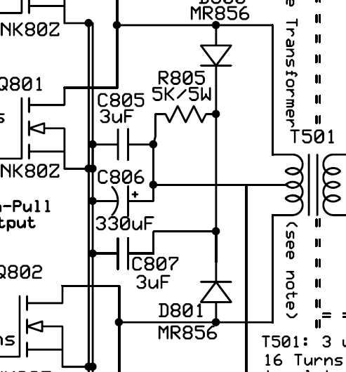

I have created a preliminary schematic of the ClipLead 400 transmitter's modulator output section (all of this is new).  The remainder of the modulator (PWM generator, etc.) is from existing schematics (and boards) and is already documented at the class E web site as part of the Pulse Width Modulator and Power Supply.
The ClipLead 400 modulator takes a standard PWM signal from the existing PWM generator board.  This signal is then fed to a phase splitter, drivers, and ultimately to the output MOSFETs operating in push-pull.  All of this circuitry is included in the new schematic.
This schematic is subject to change, etc.  Don't build any of this without contacting me first !
Comments welcome  Cool
Click on the link below to view the schematic.
http://www.classeradio.com/off_line_pwm_output.pdf

« Reply #29 on: June 04, 2008, 03:23:31 PM »
Something doesn't look right in your clamp circuit at the transformer primary
« Reply #30 on: June 04, 2008, 03:43:47 PM »
Hi Frank,
I included the circuit snippet and explanation of the clamping function in general, so everyone can see what we're talking about..  The purpose of the clamp circuit is to hold the line on spikes which result from leakage inductance and other stray elements in the circuit.  It is possible for there to be very short and very high spikes during the turn-off cycle of the MOSFETs.  In order to control these spikes, clamping and other circuits are employed.
In this case, D800 and D801 conduct energy into C807, charging the capacitor.  The "normal" voltage will be twice the power supply voltage.  High, but otherwise low energy spikes will have very little effect on the voltage across C807, however the diodes, working into C807 will effectively clamp the maximum drain voltage at twice the power supply voltage.
The voltage is sent back to the power supply through R805.  A small amount of power is lost in R805, however we are looking at only a few watts.  If one wanted to conserve the energy, it could be utilized in some way, using a buck switcher or other switching regulator.  In the interest of simplicity, I chose to drain off the few watts.
Anyway, what did you see as odd in the circuit?  It definitely works, although there may be other ways to accomplish the clamping function.  Let me know !!  Wink
Thanks !
« Reply #31 on: June 04, 2008, 05:09:31 PM »
you are limiting the flyback energy in the transformer by ac coupling it to ground through the 3 uF cap. Yes it will peak charge but I think you are wasting power. Any spikes are going directly to ground. You may have excessive leakage inductance in the transformer and lead length and this bypass is the fix but usually this energy is dumped back into the supply not ground.
« Reply #32 on: June 04, 2008, 06:05:50 PM »
Interesting idea !  I'll try an experiment by moving the 3uF capacitor's "ground" connection to the power supply and not ground.  I'll let you know if I see any change in efficiency.  Everything is metered, so I'll be able to tell right away.   Let you know  Cool

« Reply #35 on: June 04, 2008, 07:37:34 PM »
I have a real good app note on snubber design somewhere on my work computer. I will send you a copy when I find it. One other thing is R805. A wire wound resistor has a lot of inductance and ineffective in eliminating high frequency transients. 5K and 3 uf is a 15 ms time constant on a 130 KHz switcher is very high.

« Reply #36 on: June 04, 2008, 08:12:34 PM »
P material is cool stuff for power supplies.
I'd like to check out the app note if you can find it !  I figure the 3uF is pretty much a short circuit at 150kHz (.35 ohms) as compared to the 5K load.  The voltage is pure DC at that point (checked it with the 'scope)  - no 150k stuff showing up.  I've talked with a few power supply engineers and they tell me they usually have to use snubbers with this sort of application.  But, in this case the transformer is pretty good, so I don't have a lot of energy to "snub out", so to speak.
If I weren't so concerned about modulation linearity at the extremes of the pulse widths (1% - full off, to 49% which is full on), I wouldn't worry so much about the snubbers (the voltage doesn't go that far out of line), but I find that if I do not snub these tiny pulses out, they affect the modulation at the extremes - not a lot, but it's there!!  Anyway, not a big deal but definitely worth getting as perfect as possible (are there degrees of "perfection")  Wink

« Reply #37 on: June 04, 2008, 09:46:51 PM »
Yes you want to use a snubber but you just want to quench the high frequency overshoot and ripple on the drain pulse. I just worked on a switcher running at 300 KHz and due to wrong snubber design it was making a pile of crud up to about 80 MHz. We had to burn about 1/2 watt to get rid of it.
The problem was layout and transformer design. Snubber design is all about the little things you can't control like leakage inductance and interconnects.
I'm sure 15 ms TC hanging off 130 khz is well integrated. WW resistor is also acting like a RF choke.

« Reply #39 on: June 05, 2008, 10:15:07 AM »
The 1/2 watt was in a 100 watt supply so you may dissipate more unless your transformer design is perfect and very short connections. Secondary side needs to be just as good. Well read the app about 10 times and notice the time constant you need. I think we had 4700 or 10,000 pf and 2kohms in our case.
