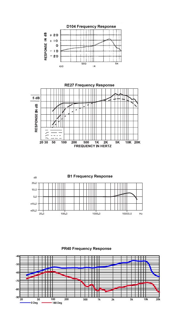

The particular final audio gear settings to obtain optimized response will depend much on a person's voice characteristics.  A few of us (like me) have natural mid-bassy voices which require the "S" EQ curve to suck out the ~110-300hz area. Into a stock, flat mike I sound muddy. Just like a custom fitting a suit, everyone needs a different matrix of audio (EQ/compressor-processor, etc) settings to have optimized audio for local hi-fi and quasi-DX AM use.
Find it interesting that some folks run a flat EQ curve while others run the 'smiley face'. Like Tom, if I were to run a flat EQ (using my PR40) I'd be the 'Mudman' for sure. While some of the difference can be chalked up to individual voices there's also the microphone frequency response ... and the combination of the two. For s&g here are plots of four mics commonly used on AM.
http://www.w1vd.com/miccomparison.jpg
note: graphs not to scale with each other
The differences are pretty dramatic when one considers that a couple dB change in certain bands of the 31 band EQ can make all the difference.

I liked the performance B-1 Excellent Mic. very warm
