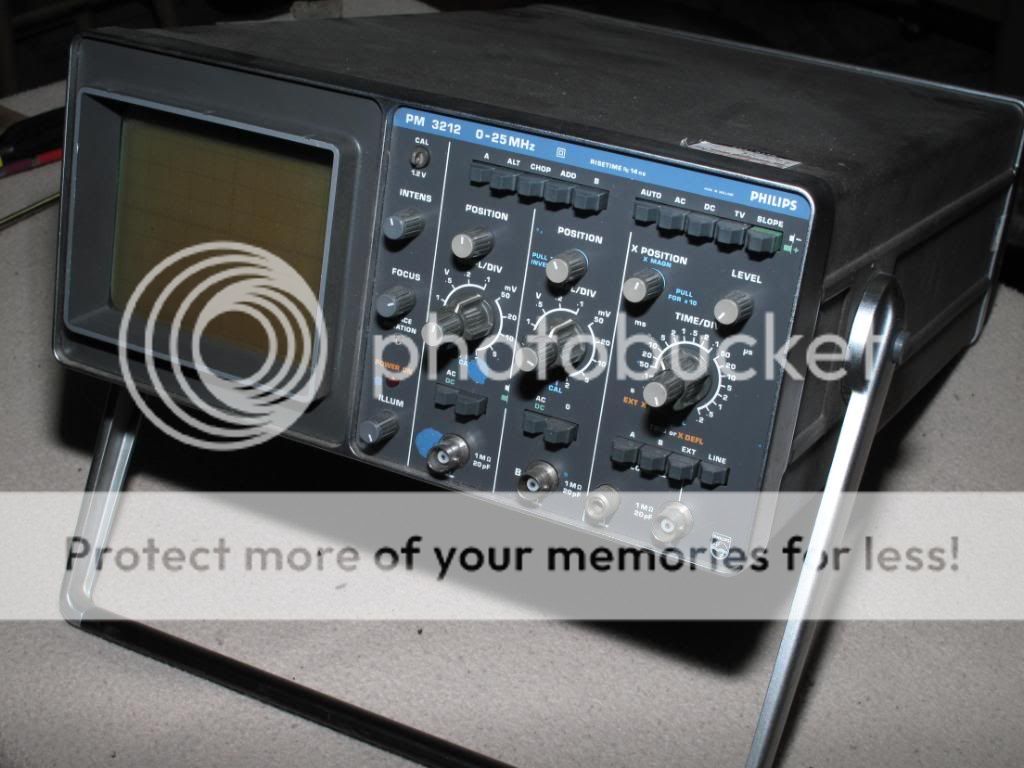

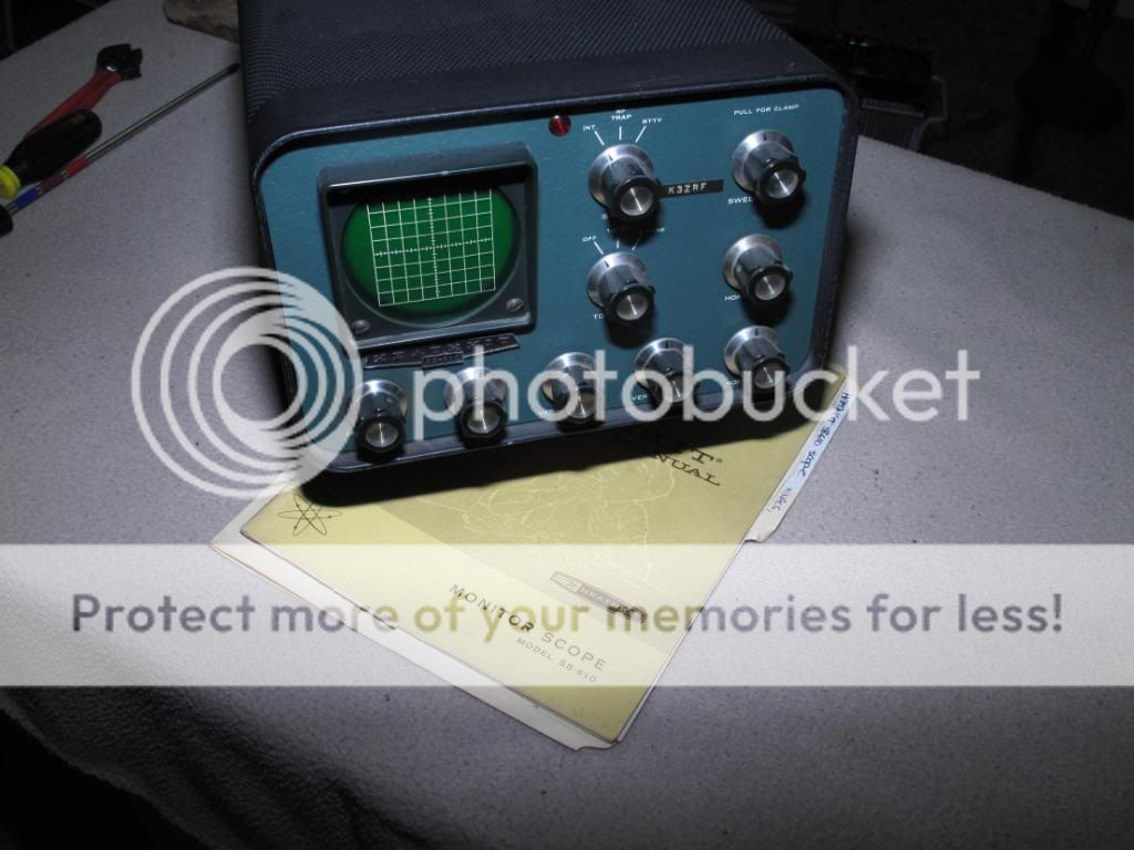

I'd also like to draw your attention to the Estate Sale of K3ZRF.
He has several scopes you could consider for on-air waveform monitoring.
Not far from you to see, buy and take with you.
There's a link in the For Sale section with details for those interested to respond.
