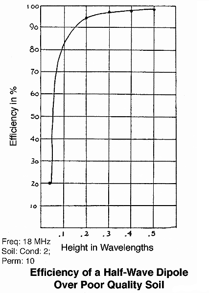

The efficiency of a dipole over ground is a function of it's height. The less conductive the ground, the greater the loss at low heights. As you can see in the plot below, once you get below 0.1 wavelength, things get pretty ugly. One-tenth of a wavelength on 75 meters is about 25 feet. The plot below was done at 18 MHz, so these numbers aren't directly comparable to 75 meters, but it's a safe bet the trend is the same.
Full sized plot at
http://www.amwindow.org/misc/gif/dipeffgnd.gif

Interesting plot, Steve.
So, it appears that a dipole at .125 wavelengths high [~30' on 75M ] is about 85% efficient. That's not bad considering the ground used for that plot is one step above urban concrete...
I see the curve starts to flatten out anywhere above 40' high or so.
For RF, the average ground depth on 18mhz is a lot less than 75M, but I would agree that the trend is the same.
Based upon that plot, I would say that the differences I've been seeing between the low and high dipole are mostly angle of radiation... being that those angles above 75-90 degrees are kinda useless, even for close in.  An 85% eff antenna must be down no more than 0.3 db from a perfect one, I wud guess.
« Reply #9 on: October 03, 2005, 11:22:23 PM »
Yep, 50% efficiency would only drop 3 dB. Another thing that may hurt low dipoles (probably not yours, since it's was away from everything) as that they will tend to couple RF into power lines, phone lines and other structures (thus telephone RFI and the like). In  my old neighborhood there were tons of wires, lines, CATV cable and chain line fences within a hundred foot radius of the antenna. The RF coupled into those structures isn't likely to make it to the ionosphere, so the signal suffers. RF getting into the telephone isn't getting into the receiver of the guy on the other end of the QSO.  Cry

Tom,
You have effectively described the advantage of a NVIS antenna.  It takes a small 2 dB hit on transmit and receive, but the distant qrm is reduced by 6 to 9 dB.  Just what you want for close-in work.  If you want DX, of course make it as high as possible.  Good test work, thanks for sharing.
Best regards,
Chris
Posts: 8886
« Reply #22 on: May 21, 2012, 06:14:32 PM »
Tom,
Best regards,
Chris
Oh, but the unlimited time and energy I tinkled away on antennas in years gone by...    :-)
Chris, you bring up a good point.  Using a low dipole to cut back the distant QRM is something I forgot about. I remember seeing its effect when the louder ssb stations started coming in and  taking out the local AMers on the high dipole - but making it easy copy on the low dipole.
Since that time I turned the low 75M dipole into a 40M dipole for local work.   But in the wintertime, that low 75M dipole would be an excellent antenna for the high angle locals - kinda like an antenna QRM filter.
