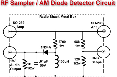

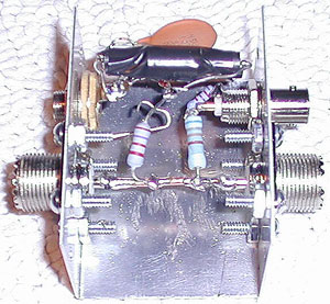

The AM Diode Detector project went well after
some technical help from K2WS, Alan.
We figured out that I purchased a bad diode. The
new one worked perfect.
The audio output level is perfect! You can run
headphones from the audio output or to a mixer with no problem.

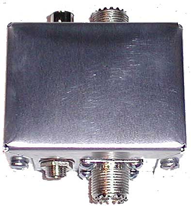

The finished box is pictured below:
