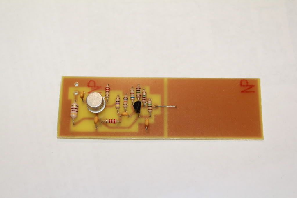

« Reply #9 on: January 14, 2012, 01:55:39 PM »
Bob, Thanks for the tip. I looked it up and it is very interesting. Does it REALLY perform as advertized?
I guess I'll find out as I put together a board this morning. It seems to good too be true.  It's hard to believe that the square of PCB copper is all the antenna element that there is.
Here's my board and I hope to test it this weekend.

« Reply #11 on: January 15, 2012, 11:29:19 AM »
First test on the little PA0 active antenna is interesting. With it sitting in the shop next to the receiver it picked up most of the beacons that I hear with the dipole. I just got a new broadband noise source show up since yesterday  morning though and it is a screacher about S9 from 10 Khz to 200 Khz.
I need to move the antenna outside.
Pat
N4LTA
Posts: 1070
« Reply #12 on: January 16, 2012, 09:21:03 AM »
I installed the test antenna outside away from the house but the results were poor -more noise than my 80 meter dipole - much worse in fact. I installed a makeshift common mode choke near the antenna and another at the receive converter but they were not optimum. More work needed.

« Reply #15 on: January 18, 2012, 12:47:16 PM »
Not sure what is going on. I have some large #31 ferrites coming and I am going to make some chokes and do a better job with the feedline. Jack Smiths antenna should be here later his week and I am hoping to put it on a pole at the edge of a small pond about 400 feet from my house  and at least that far from any other houses or power lines. I have 1000' of cable coming also. Been doing a lot of research on common mode noise and how the newer ferrites have helped improve things with regard to common mode noise problems.

« Reply #17 on: January 23, 2012, 10:47:45 AM »
I built a copy of Jack Smiths common mode choke this weekend and installed it on my 80 meter dipole. All that I can say is "Wow" .  The noise is much reduced on 80 meters and on LF - at least 3 S units  - which I would never have believed. After installing the choke - and seeing how well that worked - I wrapped the 120 VAC power lead in a core as well as the 12 volt leads to the R75 and the LF receive converter and the network cable and computer 120 volt power lead. After doing it all - I had the quietest antenna noise that I have ever seen with that dipole - in 25 years. I am a believer in type 31 ferrite now.
