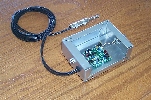

Received some questions re the 'cleanliness' of the R-390A 'big signal' display a number of posts back...
Any ground loop induced hum or noise will compromise the cleanliness of the display - this is particularly noticeable on a clean unmodulated test carrier as used for that test. Any hum or noise will appear as unwanted products close in on each side of the displayed carrier - how far down they are depends on the severity of the problem. It may be far enough down to be inaudible (or nearly so) but still be readily apparent on screen. 100 dB down is a long way!
In my situation (with the R-390A on one bench and softrock / computer a distance away on another bench) the hum and noise problems were pretty bad looking when first installed. Several things helped the situation. The 455 kHz input to the SoftRock (ANT INPUT/ANT RETURN) connections are floating above ground and keeping the ANT RETURN above ground made a significant improvement. Initially I started with a standard BNC connector on the housing and grounded the ANT RETURN. Switching to an isolated ground BNC made a big improvement.
Since there's up to 4 volts p-p at the AUDIO I and Q output it's prudent to feed the sound card with separate shielded cables - not a pair of wires inside a single shield. I used good quality RG-174 coaxial cable. One might be tempted to install a stereo jack on the housing (as I did in the initial setup) but this can be a mistake. Unless the jack is isolated from ground this can be another path for ground loop hum and noise. Running the cables out through a grommet solved that problem.
For power I used a standard coaxial power connector attached to the enclosure, however, the power supply is a regulated wall wart that is isolated from ground. The board draws about 18 mA so long term battery powered operation may not be practical.
So the only ground connection for the board occurs at the computer sound card input via the AUDIO OUT I and Q cables. This has provided the cleanest display. No problems with rf pickup from other high powered transmitters running in the shack have been noted. As always, your mileage may vary.
After using the R-390A/SoftRock/PowerSDR setup for a couple weeks now I can attest that this is one nice setup. The R-390A is an impressively clean front end (albeit a bit weak in the IMD dynamic range department) and the SoftRock/PowerSDR setup is nothing short of impressive.
Probably the best "12 bucks" I've ever spent on radio...
http://www.w1vd.com/SoftRock455.jpg
