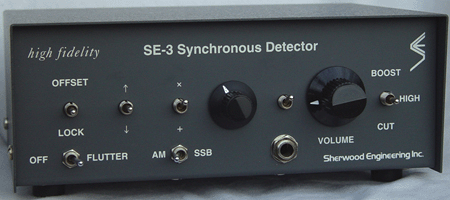

« Reply #22 on: February 16, 2008, 11:57:17 AM »
What Bruce said -- -
All I can add is that it works great and the SAM is worth the adventure.  Wth e filter and DSP I can hear stations I can't hear on the r390a alone!
G - The INR
BENEVOLENT DICTATOR & Owner  - AMfone.net - 2001 - 2010
Founding Member - NEAR-Fest
SWLR-RNŲ54
N1ESE
« Reply #23 on: February 16, 2008, 12:00:57 PM »
Hmm, a simple DC receiver for 75M shouldn't be too hard to build for use with the Softrock Lite.
- JT
N1ESE
« Reply #24 on: February 16, 2008, 12:04:23 PM »
Although changing the crystals to 15.36 MHz crystals should, when divided by 4, give a center frequency of about 3.84 MHz.
- JT
