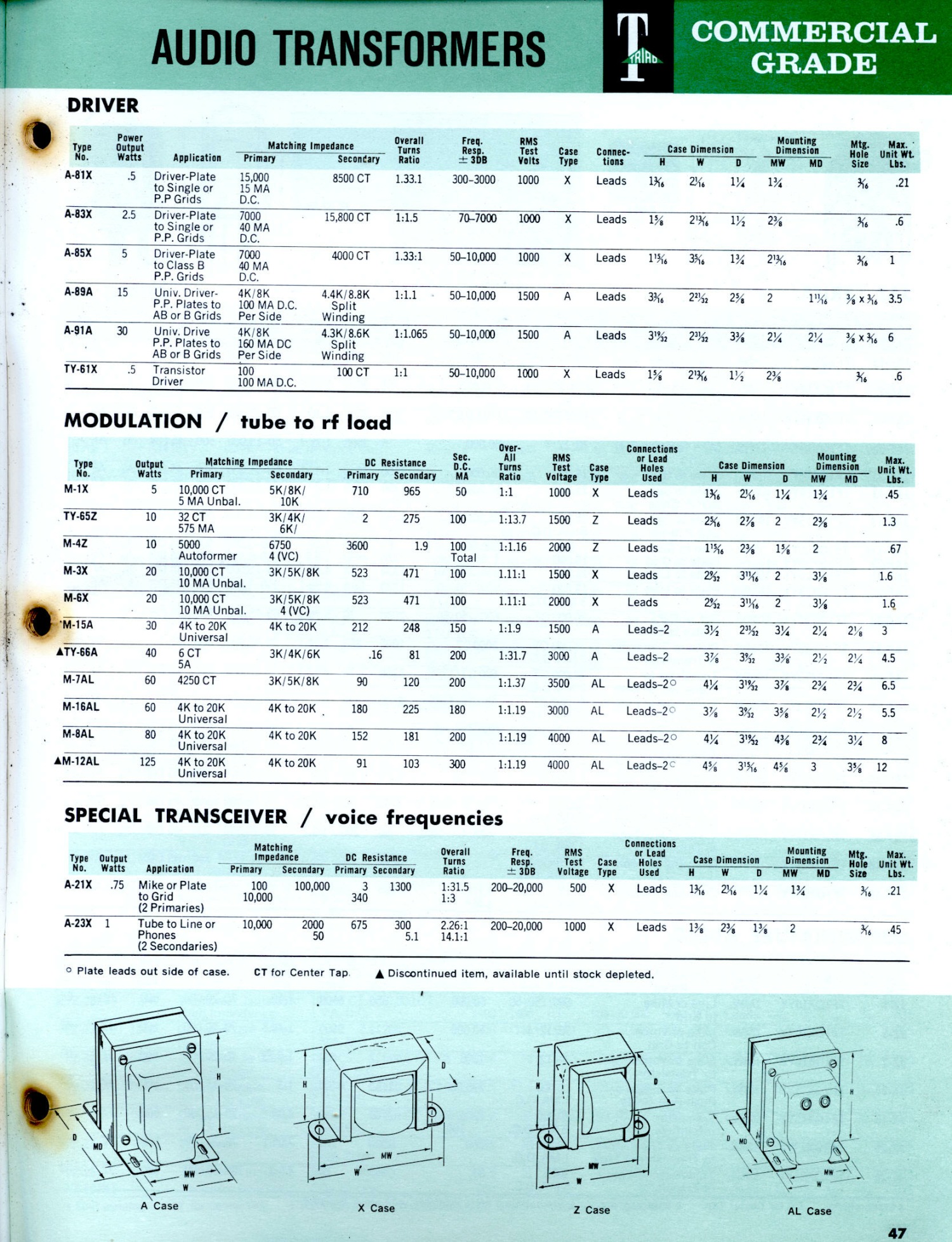

Does anyone have the specs for a Triad M12AL mod transformer?
Thanks,  Ron W8ACR

« Reply #1 on: July 23, 2009, 10:45:06 PM »
http://www.bunkerofdoom.com/xfm/71_72_industrial/triad_71_ind_0047.jpg

Thanks for the info....it helped, but I could really use a connection impedance chart if one is available.
Thanks again,  Ron W8ACR

Here's the Triad 125 watt multi-match M12AL spec. sheet that came with my transformer.
It shows lead colors vs. impedance, pri. and secondary.
I'm currently using mine in a 120 watt 6146 modulator.
I sent a copy a few months ago to Steve, WB3HUZ for inclusion in the AM Window.  He'll get around to posting it one of these days  Grin
-Rick

Thanks a lot Rick, this is exactly what I needed.
73,  Ron
