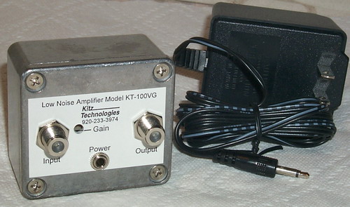

I was looking at this puppy - kinda like the homebrew look/quality - a bit pricey though.
http://cgi.ebay.com/ws/eBayISAPI.dll?ViewItem&item=280289577274
http://www.kitztech.com/
John K5PRO
