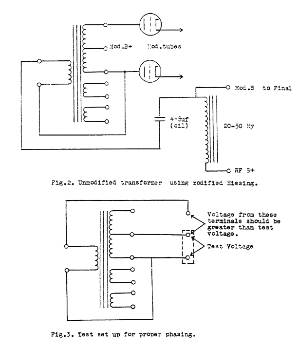

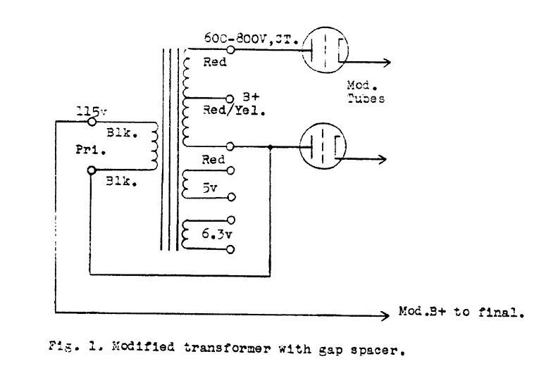

Use of TV Power Transformers for Modulator Service
The Timtron WA1HIR
There comes a time when the modulation transformer in your DX 100 Apache, B & W 5100 32V, Viking 1 or 2 Valiant or other 50 - 200 watt power class transmitter sources out. Maybe you are interested in building a low bucks transmitter or a modulator for your cw rig. The biggest stumbling block is getting a modulation transformer together. Well fear not, the TV power transformer has come to the rescue. There are a number of methods in using these beasts as shown below:
It will be noticed that there are two variations of a similar configuration. The original l15v primary is connected to one leg of the high voltage secondary (600-800v). The windings have to be in phase or else it wont modulate worth a damn. A test voltage can be applied to the center tap and one end of the secondary. The test voltage can be from 6.3 -115 volts AC. The total voltage obtained from the combination of the primary winding and one half of the secondary should be greater than the test voltage used. If it is less than the test voltage, then the windings are out of phase. In this case just reverse the leads on the primary or tie to the other end of the H.V. winding. In tests conducted on an 800 V, center tapped unit with 1l5v primary, the impedance ratio was app. 2:l; perfect for the usual set up with common plate supply and typical 6146s modulated by 807s and other lash ups where plate voltage does not exceed 800 volts. The limiting factor is insulat1on break down rating of the transformer. Most are designed for 1500 - 2500 volts breakdown. In some designs the primary is the first winding on the core. In others, the primary may be wound 1n the m1ddle or on the outside. The types with the primary wound on the inside is more susceptible to crap-out. The transformer may also be mounted or insulated above ground in order to accommodate higher working voltages. You may ask yourself: How does a power transformer behave at audio frequencies? Amazingly enough most will have very good response characteristics. There are so many variables that it would he difficult to accurately predict what it will do. Power handling capabilit1es of the usual TV power transformer is in the order of 150 - 300 watts depending on the size of the core. It can generally be assumed that 1 lb. of core material wi11 handle 10 watts of aud1o for good, bass response, and 20 watts per pound with higher impedance, i.e.; PP 811 to 813 final 1250- 1500 volts.
In figure 1, the DC to the final flows through the transformer to the final. This causes an imbalance of current in the transformer, and core saturation to occur, therefore; the transformer must be modified. If you are observant you wil1 notice that typical modulation transformers, filter reactors and audio output transformers for single ended operation have "E" shaped laminations stacked together next to "I" shaped laminations. The "E" and "I" shaped stacks are separated by a heavy paper spacer. This enables the transformer to handle a certain amount of DC imbalance, but there are drawbacks. When this is done, the inductance of the transformer falls off rapidly as the spacing of the gap is increased. This causes a marked drop in the low frequency response of the transformer.
In the case of the power transformer; a gapped power transformer will work okay for frequencies of 70 - 5000 Hz. In order to modify the transformer, the whole unit must be disassembled. Remove the bolts holding the cover bells in place. With the careful use of a hammer and several sizes of screwdrivers, it is possible to do the job within an hour. It may be necessary to give the core stack a couple of well-placed whacks to loosen up the laminations. Some transformers come apart easily and others take much patience. Exercise extreme caution not to damage the windings. Once the unit is apart and the laminations are clean of foreign matter, group the "E" and "I" laminations into two separate piles. An educated guess wi11 have to be made for the thickness of the paper gap. For plate currents of 200 -300 mills try a piece of paperback book cover. For currents of 75 - 150 mA a sheet of paper from this magazine should do. Assemble the "E" laminations into the core of the windings. If you cant get the last remaining pieces in dont worry, it will have little affect on performance. Cut the gap spacer to the proper dimension and epoxy the spacer between the "E" and "I" group. Insert the bolts and compress the laminations with a large vice or heavy weight. This forces the epoxy to fi11 into all the crevices between the "E" and "I" laminations. The epoxy step must not be eliminated or else loud talk back will result causing acoustic feedback not to be believed. If the work has been done properly, you now have a modulation transformer.
In configuration #2, the DC to the final is handled by an inductor. The usual rule of thumb is 10hy to every 1000 ohms of class C load impedance. This can be made up by series-ing up several power supply chokes. Smoothing chokes must be used. You can get away with as little 5hy per 1000 ohms of impedance with some loss in bass response. Since there is no DC imbalance in the transformer, no modification is needed and is a better way to go than figure 1. Low-end frequency response is much better and time is not wasted in transformer modification. In addition to these benefits, separate supplies may be used for the modulator and the final. The coupling capacitor used is a 4 - 8 mfd oil capacitor. More capacity can be used if desired. Electrolytics can also be used, but two must be used in a back to back configuration. A non-polarized unit such as a motor-start or run capacitor can be used also. The voltage rating in the case of a common supply can be very low; say 10% of the DC potential used assuming that its capacitance is great enough not to allow very low frequency audio transients to develop across the capacitor that would crap it out. If a rectangular oil type of oil cap is used, it is advisable to float the case above ground.
In terms of impedance matching here is a table of computed values with most common voltages found:

Table 1. Impedance ratio with typical power transformers. Values in Table 1. are AC ratings of secondaries with 115-volt primaries. Values given are full primary to secondary in modulation service.
For example, to modulate a DX 60 with these parameters: 700 volt @ 125 mA presenting a load of 5600 ohms. This will present a load of app. 10K to which are a pair of 807s 1n ABl configuration. With 600 volts this will deliver close to 45 watts of audio required to modulate fully. A 500 Vct transformer, and a 10 mfd oil is found in your junk box with several filter chokes having values of 10 hy, 150 mA, 8 hy, 200 mA, and 16 hy, 150 mA. Combined they make 144 hy which is sufficient for our purposes. Once assembled, it is found that your modulator is performing much better than you thought; and the most expensive component, the modulation transformer cost you nothing at all, and was put together from otherwise useless junk. In the case of replacement of the modulation transformer in a DX 100 or Apache, where space may be limited, you can solid state the power supplies and move around components to make room for additional chokes or insta11 a restructured unit with gap spacer. This was done to an Apache w1th good results recently. In the case of a Viking Valiant, converting the HV supply to solid state and moving the screen dropping resistor provides plenty of room for two typical 10 hy, 300mA chokes. An old power transformer can be squeezed in place of the original transformer.
You may be wondering what to do with the filament windings. They can be used for a variety of things. A 600 VCT unit with a 6.3 VAC filament winding used with 5K PP load impedance will present a load of .5 ohm at the filament winding. This makes an ideal pick off point for monitor headphones. The voltage step down ratio is such that enough level will be at the filament winding to drive headphones or a speaker without blowing your ears off. You can also use the filament winding for a loop of negative feedback to an earlier stage in order to improve response and, distortion characteristics, or for an audio take of for trapezoidal scope pattern. GOOD LUCK!
My special thanks to Sue KB2IRH for redrawing & retyping this work.
