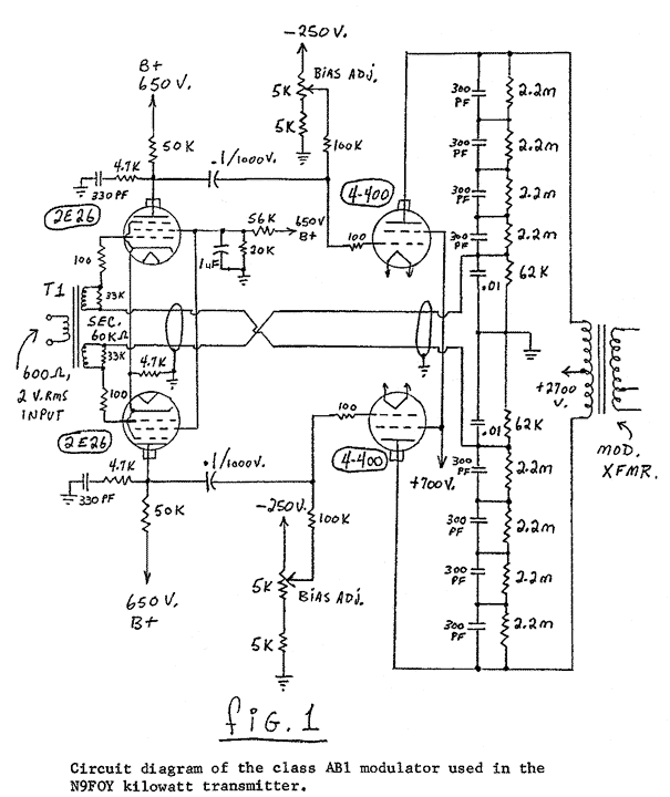

The N9FOY One Kilowatt Transmitter
by Steve Konopka, N9FOY
In early July of 1986, after having spent my first six months as an Amateur having fun running strictly AM with relatively low power, I developed a serious desire to both upgrade to full legal input power and build my own 1 KW plate modulated transmitter.
Having both a finite amount of time to budget toward the hobby and a respect for well-established methods, I opted to design the rig around well-proven circuitry of rather conventional nature.
In budgeting for the various components which had to be purchased, I applied the philosophy that since I have chosen to operate both exclusively and effectively on AM phone, I should expect no less of an investment than that of a serious operator of some other mode.
The N9FOY kilowatt employs a type 5762 external anode power triode, which has a 3 KW plate dissipation rating. This was obtained as a pullout from a radio station, This tube type is also used in older TV transmitters, and it may be interesting to note that it is rebuildable upon wearing out. The 5762 serves as my class C final, requiring 80 watts of drive which is supplied by three 807's in parallel. Modulation linearity was perfected by applying 75 percent modulation to the driver stage. The transmitter's RF output network consists of a double pi section, employing a combination of variable-vacuum and fixed mica capacitors. The final plate is loaded to 370 mA at 2700 volts. RF excitation for 160 meter operation is provided by a home-made VFO which consists of a modified 1960's vintage Chevrolet car radio, wherin advantage was taken of the permeability-tuned local oscillator section. On 80 meters, I excite the rig with the driver stage of a National NCX-5.
While I hadn't made a firm decision on the choice of a modulator even after construction of the transmitter was well under way, I believe I was subconciously certain all along as to the winning candidate, that being class AB1 4-400C's, driven by push-pull 2E26's. This circuit, illustrated in fig. 1, has proven its excellence in the field for many years in a top-of-the-line broadcast rig. 10 dB of inverse feedback provides a large contribution to its high-specification performance.
Fig 1 - Schematic of N9FOY modulator
The modulation transformer is a Peter Dahl Co. 1 KW "universal", which matches the 4-400C's 11 K-ohm plate-to-plate impedance to a 7300 ohm class C load. Incidentally, we're not really talking "big iron" here--it has a hypersil core, resulting in both smaller size and less weight than most of the older 500-watters I've seen. A 30 Henry modulation reactor was obtained in the form of a fried hulk from a broadcast station. My patience was admittedly well tested during the process of counting the original wire turns and rewinding the coil in the absence of any special equipment.
The transmitter was completed in March of 1987. Prior to putting it on the air, I elected to make substantial performance tests, ranging from final stage plate efficiency to audio harmonic distortion. Since the theoretical average power output under 100 percent sine-wave modulation would be 1125 watts, I was faced with the need for a hefty dummy load having a continuous duty rating. This was easily satisfied by placing a simple L network ahead of an old electric stove burner. VSWR increased only slightly with the coffee pot in place!
After a few days of testing and de-bugging several relatively minor problems, I commenced with on-air operations. The rig has been providing me with many pleasurable contacts ever since.
