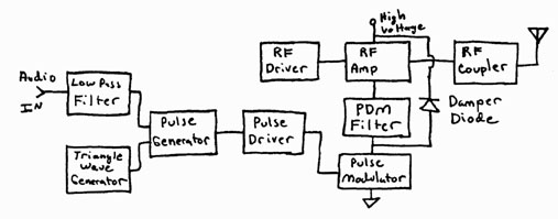

DESIGN OF THE BASIC SYSTEM
Figure B shows a functional diagram of a PDM transmitter. Each functional component will be discussed separately.
Pulse duration modulation generators
A PDM Generator is any circuit which produces a pulse whose width is proportional to the input amplitude of the applied signal. A simple method of producing such a signal uses a differential comparator and a triangle wave generator. A differential comparator generates either a high or low output (digital signal), based on the voltage difference between 2 input signals. The triangle wave is fed into one input, and the modulating signal is fed to the other input. Referring to figure C, the triangle wave generator is fed to the "-" input of the comparator. The audio to the "+" input. The comparator works as follows: When the level of the "+" input is higher than the level of the "-" input, the comparator generates a logic 1 (high) output. When the "-" input is higher than the "+" input, a logic 0 (low) is generated. Let us assume, for the moment, that the triangle generator produces a 10V peak-to-peak output. The "-" input of the comparator is, therefore, varying between +5 and -5 volts (10v P-P). If the signal fed to the "+" input is 0, the output of the comparator will be an exact 50% duty cycle square wave. This is illustrated in figure C(1). Let us now connect a +1 volt DC source to the "+" input of the comparator. If no other factors change, the output from the comparator will very closely resemble the signal shown in figure C(2). The reason that the 1 (high) pulse is longer than the 0 (low) pulse is that the portion of the triangle wave which is less than 1 volt, and therefore makes the "+" input greater than the "-" input, is wider than the portion which is greater than 1 volt. If now, rather than connecting a DC signal to the "+" input, we connect a sine wave to the "+" input, we will produce varying width pulses whose width depends on the width of the triangle wave for the time where the "+" input is greater than the input. The pulse train shown in figure C(3) shows the variable width pulses produced by a sine wave input.
As we mentioned earlier, the output from the comparator is a digital signal - that is, the signal has only 2 possible states, high and low. The information (modulation), rather than appearing as an amplitude change, as in the input, appears as a change in the ratio between the times that the signal is high and low. The amount of change is directly related to the amplitude of the input signal, and the rate of change is the frequency of the input signal. One of the nicest aspects of pulse duration signals is that they can be amplified without regard to amplitude linearity - in fact, the best amplifiers for this application are amplifiers designed to operate in the saturation/cutoff, or switch mode.
The triangle wave generator must produce perfectly linear triangles if good modulation linearity is to be expected. The distortion characteristic of the transmitter is determined more by the design of the triangle wave generator than any other part of the modulator. Care must be taken to ensure that the output of the triangle generator is unaffected by the input signal, power line variations, RF or any other outside factor. The tips of the triangles should be sharp and pointy. If they are rounded, nonlinearity and distortion of the modulating signal will occur. The sides of the triangles need not be identical in length. Often, the output will more resemble a sawtooth than a triangle. This is OK as long as both sides are perfectly straight and linear. A good circuit for a triangle wave generator will be presented later.
The switching frequency (determined by the frequency of the triangle wave generator) should be at least 4 times as high as the highest audio frequency you want to modulate. This ensures adequate resolution of the high frequencies and reduces the possibility of aliasing, a type of distortion caused by the mixing of the switching frequency and the input signal. It also makes design of the output filter easier. However, if the switching frequency is too high, the pulse generator and amplifier design will become difficult, due to the higher bandwidth required for high switching frequencies. Switching frequencies of between 50kHz and 100kHz are used in most Pulse Duration Modulators with 70kHz being very popular with broadcast equipment designers.

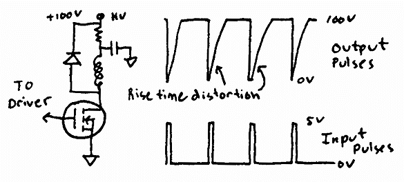

Modulator considerations - Special Problems
Single-ended output pulse modulators, whether tube or solid state output, can suffer from a common problem which can cause distortion of the modulated wave at high percentages of negative modulation, unless special measures are taken to prevent it. A description of the problem, and some solutions follow.
If we go back to our original example of the basic pulse duration modulator described earlier, when the modulator device (switch) opens, the voltage rise is dependent on the energy stored in the input inductor. Any capacitance which exists in the modulator device, filter components, wiring, etc will slow down the rise time of the signal. At high percentages of negative modulation, the on-pulse width is very small and results in very little energy storage within the inductor. Since there is so little energy available to charge the stray capacitance, the rise time of the pulse becomes quite long. This causes the modulation to flatten out, as 100% negative is approached, until the input pulse becomes so small that the driver bandwidth limit causes the input pulses to disappear altogether, at which time the transmitter will suddenly reach 100% negative modulation. Large corporations such as the Harris company have spent much time and effort in trying to solve this problem as has the author of this article. Figure F shows the output pulses, and the pulse distortion.
Several solutions currently exist which will work around this problem. One solution is to use an active pull-up in the modulator. This can be accomplished by using Totem-pole or complementary-symmetry in the modulator output. Another solution is to simply reduce the level of the modulator input pulses, along with the pulse width, so that, as the input pulse width is decreasing, so is the drive level. By the time the input pulses are small enough where the output pulse distortion would be a problem, the tube is operating almost as an analog amplifier, and is cut-off before the input pulses become very small. This is the solution which I used in my KW amplifier. The tube is only operating in the analog domain when the transmitter is near 100% negative modulation, and is handling very little power, so the efficiency of the system is reduced by only a very small amount.

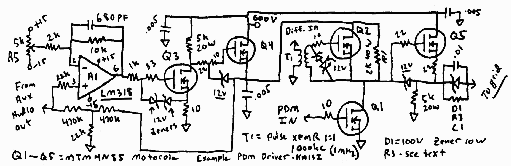

Driver Considerations
If the modulator device(s) are solid state (FET, Transistors, etc), then the pulse amplifier or driver will be only be required to produce a few volts of output. However, since the input capacitance of solid state devices can be very high, the driver must have a low impedance, and be capable of delivering a high peak current in order to charge the input capacitance of the modulator devices quickly, and maintain a good rise and fall time. The pulse generator shown earlier in figure E will drive a solid state MOSFET modulator directly.
If the modulator device is a vacuum tube, then the driver must deliver a high voltage to the grid-,at the peak grid current at which the modulator will be operating. Although the grid of a tube has a fairly low capacitance, a low impedance driver circuit should be used to maintain good rise and fall times of the pulse waveform. It is recommended that an emitter or source follower, or other low output impedance circuit be used ahead of the grid of the modulator tube. If the driver must deliver a varying level to the grid of the tube (recommended to reduce distortion), then the driver must incorporate a good analog amplifier which will control the level of the driver output pulses.
The use of power MOSFETs is recommended over standard bipolar transistors for both solid state modulators and drivers for vacuum tube modulators. The MOSFETs have a very low on-state resistance, are available with higher breakdown voltages than bipolars of similar power, require no gate current (bipolars require base current), and are generally less expensive than similar bipolars. MOSFETs can be driven directly with TTL logic (as shown in the driver example), which greatly simplifies the circuit design.
Figure G shows a pulse driver. The driver circuit shown produces varying height pulses up to 600 volts, for driving the grids of pulse modulator tubes. The PDM output from the pulse generator is fed to the gate of Q1, which forms a voltage amplifier with drain resistor R1. Q2 is fed differentiated pulses which occur on the falling edge of the input to Q1. When Q1 turns off, Q2 is turned on, improving the rise time of the output. The pulse amplifier formed by Q1 and Q2 receives power from emitter follower Q4. Q3 and Q4 form an audio voltage amplifier driven by A1. Resistor R5 sets the DC level produced by the voltage amplifier. Audio is fed to A1 from the output of the pulse generator auxiliary audio output. Since the pulse amplifier receives its power from the audio voltage amplifier, the pulse output level is controlled directly by the output of the audio voltage amplifier. This produces varying height, varying width pulses, which depend on the level of audio. The output from the pulse amplifier is fed to source follower Q5, which drives the grid of the modulator tube. A grid leak bias network formed by D1-R3-C1 provides -100Volts bias for the modulator. The value of R3 depends on the grid current of the modulator. If a large enough zener diode, D1, is used, the resistor is not necessary. A 10 Watt Zener was used in this example, so the resistor is necessary to prevent burning out the zener.
Figure G

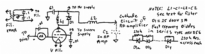

Damper Diode
The damper diode conducts the flyback energy developed when the modulator device is turned off back to the power supply, clamping the waveform to produce a good square wave. The diode must switch and recover fast enough so as not to allow "spikes" before the diode turns on, or dissipate large amounts of power when the modulator turns on. There are many fast-recovery solid state diodes on the market which will work in the application. Normal power supply rectifiers are too slow for switching duty, and will burn up excessive amounts of power in switch service. For a high voltage application, it will be necessary to use several solid state diodes in series with equalizing resistors. The cathode of the diode must be well bypassed to the modulator chassis so ensure a good clean switch of the rising edge of the wave, as the damper begins to conduct. This energy is, of course, returned to the power supply. The damper diode is handling a considerable amount of power, and should be chosen with this in mind. I used a string of 25 600V 3A fast recovery diodes with 270K 1w resistors across each diode for equalizing. Note: DO NOT use mercury vapor rectifiers, gas tubes, or standard power supply solid state rectifiers for the damper diode!! These devices are too slow for the application, and will most likely burn up or arc over in the application.

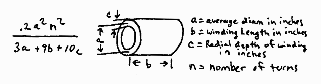

Output filter construction
The construction of-the output filter is very important. One of the biggest problems encountered in filters of this type is ringing. Any ringing in the switching waveform will cause distortion of the modulated signal. Another problem is self resonance in the inductive elements. Once a filter is constructed, and the modulator completed, the waveform occurring at the input to the filter must be checked over the entire range of pulse widths to ensure that no ringing, waveform distortion or other anomalies which will cause distortion.
The best kind of inductor I have found for use in these filters, at least for the input inductor is an air-wound RF choke. For modulators designed to modulate RF amplifiers with an impedance of around 8000 ohms, values in the range of 40mH to 70mH are typical. These are fairly large inductors. The choke has to be able to withstand the full power supply voltage (in my case, 10000V) across it, and be able to carry the full peak current under maximum modulation. It should also have low resistance, since you don't want to burn up too much power in the choke!
A 40mH inductor air-wound inductor can be wound on a 4 inch form (I use 4 inch PVC pipe), 5 inches long, with around 600 turns. A rough estimate of the inductance can be calculated using the following formula:
Click here for graphic of formula
I used #22 gauge enameled wire to make the chokes. The chokes are wound in layers. Each layer is wound in a criss-cross fashion to minimize any resonances. Between each layer of wire are 6 layers of waxed paper. I started off with 20 turns per layer for about the first 10 layers or so, then dropped to 15 turns per layer for the next 12 or so layers, then went to 9 turns per layer for about 15 layers, then 6 turns per layer for 10 more, then finally just 3 turns for the last 5 layers.
THIS DATA IS APPROXIMATE! The number of turns, and the number of layers depends on the value of inductance you need, and the voltage that the choke has to withstand. Don't be intimidated by the construction of the choke. I’ve made 5 of them so far. Once you get the hang of it, you can make one in about 4 hours.

Building the Modulator
Although the modulator section (following the pulse driver) is fairly simple, there are some conditions which must be analyzed. Since the modulator is handling RF frequencies (the switching waveform), with very fast rise and fall times and high harmonic content, the cathode of the modulator (if a tube), and all other leads leaving the modulator cabinet should be suitably bypassed to prevent generation of BCI and TVI. If the cathode is not bypassed with a low reactance at the switching frequency, the inductance of the filament transformer will isolate the cathode from true ground, and may cause unpredictable results in the modulator.
The collector, drain, or plate circuit of the modulator must not introduce any more stray capacitance to ground than necessary if good rise and fall times of the pulses are to be maintained. To this end, the filter should occupy the same enclosure as the modulator, with a direct, unshielded, unbypassed line going from the modulator to the first filter element. The remainder of the filter need not be located near the first reactor, since there is a relatively large capacitance following the first reactor, although it may be convenient to keep the whole filter in one location. Figure H shows the modulator, filter, and damper diode as part of a PDM transmitter.
Figure H

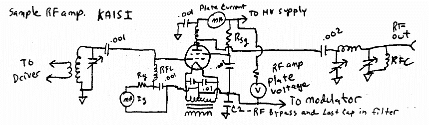

The RF amplifier
Up to now, there has been little discussion of the RF amplifier. The RF amplifier is a standard class C amplifier which is designed to allow a varying DC voltage to be imposed on the negative side (cathode side). and a fixed DC voltage on the positive side (plate side). The DC paths for the grid and cathode circuits must float above ground, while the RF paths are referenced (and bypassed) directly to RF ground (chassis) as in a normal RF stage. It is not necessary to float the entire grid circuit above ground, and the RF may be coupled to the grid through a high voltage capacitor or RF transformer, allowing the use of normal grid components, so long as the DC path does float along with, and is referenced to the cathode.
It is highly recommended that the last capacitor in the PDM filter be used to bypass the cathode of the RF amplifier to ground, as part of the RF amplifier. This will result in the most stable RF design, while still maintaining the proper value for the filter. A capacitor with a low series inductance should be used. All other grid RF bypasses and references such as the grid leak resistor, screen bypasses, suppresser, etc must be connected to the cathode, so, as the cathode voltage varies with respect to the plate, the control grid voltage is NOT varying with respect to the cathode.
If a screen resistor is used, in the case of a tetrode or pentode, the resistor is simply connected directly to the DC plate supply. All circuit components with the exception of the filament transformer, which must withstand the full power supply voltage under 100% negative modulation, are the same as a standard dc-grounded cathode, class C RF amplifier. Figure I shows a representative RF amplifier, used in a PDM transmitter.
Figure I
